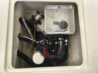

    Because it get pumped out immediately, if you have a good system.
    My bilges are also dusty, I hate standing water in the bilge making a Petri dish under the floor boards.
    (Disclaimer: I only have owned 2 boats with cabin A/C, but worked on quite a few big boats with A/C systems)
    On my present boat I installed a sump-pump with a suction tube much lower than the forward bilge pump could pick up: Upper left hand corner in the picture:

    That looks like a pretty normal set up where the higher pump would be connected to an alarm, but what is that electrical gizmo near the pumps? Unless it's an optical illusion that looks like it could get submerged and it doesn't look to be made for submersion.
  18. NYCAP123
    11,210
    Most bilge pump setups I've encountered would kick it overboard at about 1 gallon, about 1". BTW, on that 66 you probably have 4 or 5 A/C units together in one location. So why not direct the condensate into a sump, but on smaller boats you're dealing with units scattered around the boat. Why waste the money on the extra plumbing? Plus if the sump or one of those hoses gets clogged it's going to back up into the salon or stateroom.
