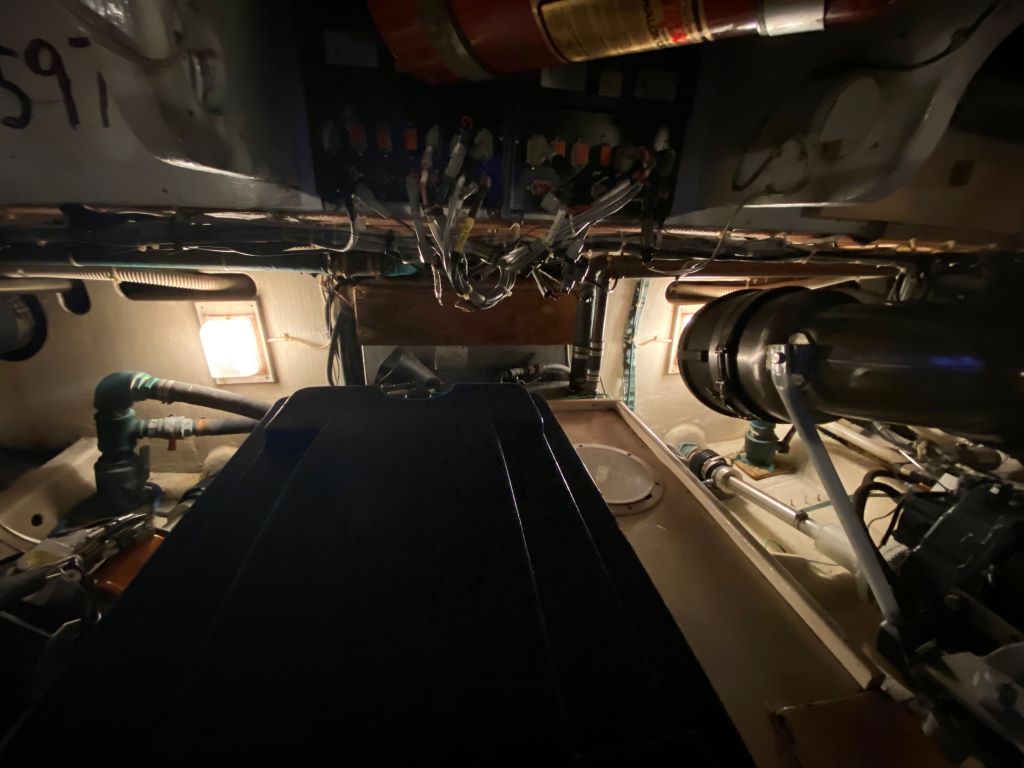

    IMG-2384-small.jpg The main engine cooling seacocks are outboard of both engines/shafts. On the stbd side you can with difficulty crawl across the shaft (if not running) to get to the seacock. On the port side with the seacock behind (below) the exhaust the only way to get to it is by going around the engine from the front and go aft along the outside.
    The stbd would be difficult in an emergency, the port nearly impossible. Has anyone rigged some type of remote cable/lever/etc so you can easily close them? If so would love to see your system.
    Thanks

    If I can’t easily reach a sea cock or any other critical component... I don’t buy the **** boat or I plan to move them at the first haul out. Cables won’t be strong enough to handle a large sea cock.

    Some cocks offer a 1/2" square hole in the handle end. Good for a 1/2" drive ratchet or breaker bar.
    There are off-set tools also available to help in hard to get to locations.
    However, I do agree with Pascal, If these important items are installed in bad locations, No telling what other items were not thought thru during design and construction.
    I would have had serious reservations on this if I was the purchaser.
    That big bin in the way does not look factory. Would removing that help get to the cocks?

    The seacocks are in the factory location so existing Post owners must have already found a solution. The 1/2 square drive fitting with a custom extension might work on stbd, but the handle is on the outside on port. I will find something workable (my 402 Formula had extensions that allowed reaching seacocks in the bottom of the engine bay from the top), just looking to see how current owners have dealt with it so I don't reinvent an existing solution.
    I don't know what the owner has in the bin, but I would plan to remove it.

    I put zerk fittings in mine a few years ago and it kept them smooth enough for me to hand exercise them with a piece of PVC pipe just long enough to get them started. I also put a pair of these in the pit to grab in a hurry. https://www.topshelfmarine.com/product/sea-cock-ball-valve-helper/ Groco put zerk studs in so you don't have to tap the holes, unless you break those little babies off. Do this out of the water.

    From the pic I don't see a problem or anything out of the norm. Things on boats often require contortions to reach. I've never seen the handle holder J cited. Not bad, but the angle worries me for the stress it'll put on the handle. Personally I'd just keep a small length of galvanized (not PVC) pipe there to slip over the handle for better leverage. I commend the poster who checks his sea cocks at the start of season and monthly during the season. From your lips to every boater's ears.

    Have to agree, unless its just really hard to tell the proportions in the picture, the location of both, while not perfect, seem to fall within the "normal" range compared to other boats. The bin is the only issue I see. Without the bin in the way you should be able to put yourself in a position to reach across the shaft and grab either handle without much effort.
    Looks like those raw water hoses have seen better days though ..

    That bin looks like a battery box to me

    Not batteries. There are 3 battery sets all located forward in engine room.

    No... there is always a way to make things easier to reach, it may take a few feet more hose and an extra hour of labor to install. When I repowered my Hatteras I moved the engine away cocks from under the shafts by to the front of the engines. Easier to access. Same with the air con sea cock.
