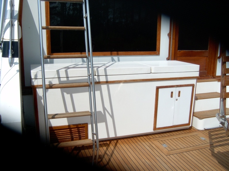

  6. 54' Bertram
    54' Bertram Member
    May 4, 2006
    67
    New Orleans, Louisiana
    here is a picture of my tackle center
  7. CaptOz
    CaptOz Member
    Apr 13, 2009
    100
    Miami, Fl
    I have an '86 and my tackle center is Identical. Were you able to remove it?
    Is your deck teak original? It looks brand new!
    Regards,
    Ozzy
  8. 54' Bertram
    54' Bertram Member
    May 4, 2006
    67
    never figured out how to remove it. I can open the tackle drawers and remove the drawers and see 2 or 3 bolts going into the deck. I can also see, or actually feel some around my freezer compressor but that doesn't seem like enough. I really would like to be able to move it since my live well is set up so the drain is forward and the fill is aft. I always have an inch or two of water in there that doesn't drain. if I could move my center, I could switch the drain and fill tubes. I also have a sink I never use. would love to disconnect it and put in a grill.
    do you have a matching single tackle center piece on your starboard side? I don't and wish I did.

  10. NYCAP123
    11,210
    Any chance it is bolted to the wall instead of the floor? That would explain the filler piece behind.
  11. 54' Bertram
    54' Bertram Member
    May 4, 2006
    67
    nope, not bolted to the wall. I can see the space between the tackle center and the wall. the shelf that forms my initial step out of the salon to the cockpit runs the entire width of the cockpit and overhangs the wall below it by about an inch.
    and in an earlier post I asked Ozzy if he had the matching single piece tackle center that sits on the starboard side. If any of you guys know were there is one for sale, please let me know. being in New Orleans, we don't have a lot of salvage boats or Berts for that matter here.
    Thanks!
