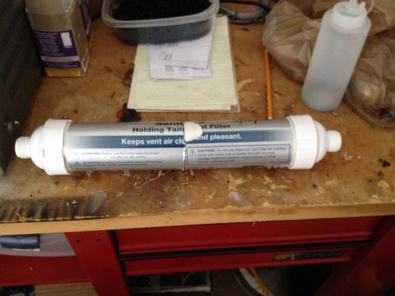

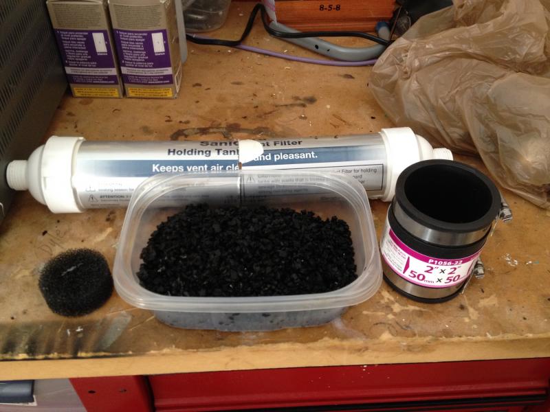

    I replace this Sealand filter about once a year. Depending on where you go they are from $75- $125. After replacing my most recent one I decided to cut open the old one. Its a 2" piece of PVC. I found it filled with granulated charcoal and a round piece of screen on each end to keep the charcoal inside. See pictures.
    So I ordered a 4lb jug of activated charcoal from buyactivatedcharcoal.com. Went to HD and picked up a 2" Fernco coupling. Cleaned pvc and screens with hose and put new charcoal in pvc tube and used the Fernco coupling to put back together. Total cost. $4.00 coupling and 4lb box $35. The charcoal should last me for the next 5-10 yrs.
    Anyone else do this? All I can say is there are some huge margins with this component.

    I've had the screen inside of the filter can disintigrate and then the charcoal gets packed into the vent hose blocking it. Quite honestly, I don't think you'd smell anything outside of the boat 99% of the time without having the filter like all of the boats built before 1990.

    I prefer your clamp connector vs the threaded as on the eBay version. With the clamp you don't have to pull the hose of the end fitting to unscrew the assemble...
    Those filter are a pain. Unless the vent is close to an frequently open hatch or near the cockpit or aft deck, they re usually not worth having.
