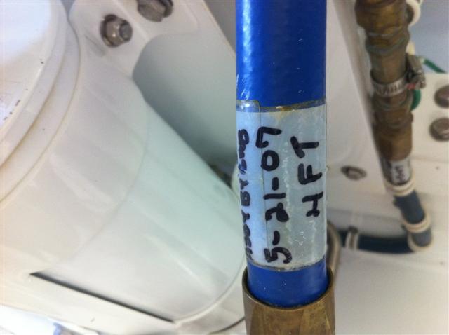

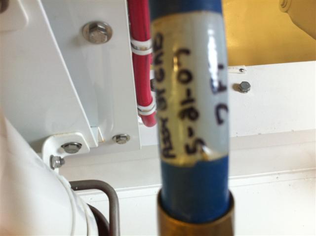

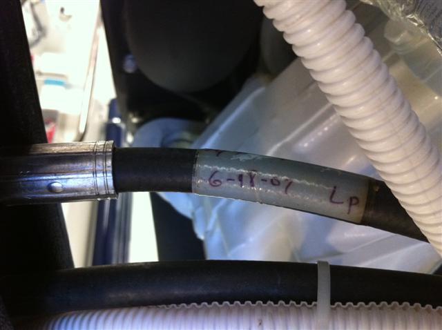

  19. SHAZAM
    SHAZAM Senior Member
    Jan 26, 2008
    601
    The Ghetto
    Here are the lines in question, not just off the shelf lines but lines that had to be made IMO after the yacht in question was assembled...
