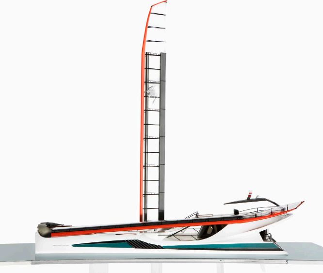

    also tell your mate (Adam Vorhees), that his cat (Riparian) looks very impressive. and what length did she end up?
