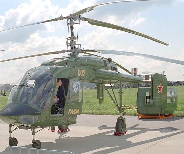

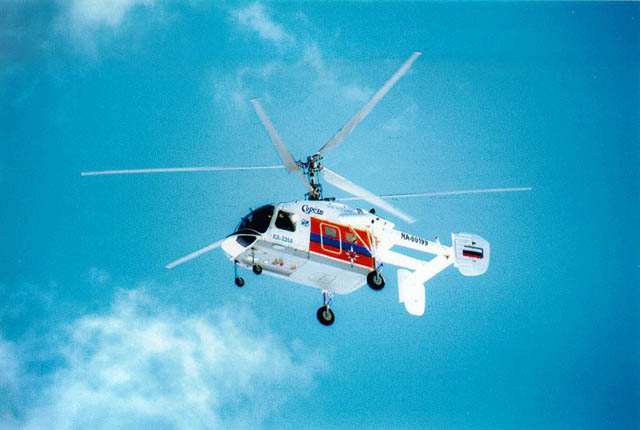

    Have you had a look at the Russian Kamow.
    They are equipped with modern (vestern) engines, have good bad-weather-capabilities with the coaxial roters.
    Coaxial Rotors: http://www.kamov.ru/market/encycl/coahe.htm
    Econoical and well tested.
    I was thinking, especially about their KA-266 multirole
    Multi purpose: http://www.kamov.ru/market/tablen/26.htm
    The really special thing with this Heli?
    You can exchange the rear cabin or fly without.
    Change from Passenger transport to Ambulance or Cargo hawler in minutes.
    Mount a winch, lift and cary 1500 kg cargo (3300lbs)
    Ka-226 main characteristics:
    Engine type twin Allison 250-C20R/2 (SR) turbo-shafts
    Engine power, hp. 2 x 450
    Take-off weight, kg 3400 / 7480 lbs
    Payload,kg 1300 / 2860lbs lbs
    (Maximum transportable cargo, kg
    - inside the transport cabin 1400
    - on external sling 1500)
    Main rotor diameter, m 13.0 / 42'5''
    Max. speed, km/h 205 / 128 mph
    Cruising speed, km/h 195 / 122mph
    Hover ceiling, m 2000 or (also seen:) Ceiling m - hovering 2500 - service 6200
    Dynamic ceiling, m 5,000 /16400'
    Max. rate of climb, m/s 10.6
    Flight range, km 600 / 375miles with standard tank
    Passengers capacity 6-8 + 1 + 1 pilot
    Transport-passenger cabin dimensions, m
    - length 2.35 / 93'
    - height 1.4 / 55'
    - width 1.54 / 61'
    KA-226 http://www.kamov.ru/market/news/sh1.htm
    Gallery http://www.kamov.ru/market/galler/226e.htm
    Speecial http://www.kamov.ru/market/prod/specen.htm
    I find this to be a very interesting heli. Perhaps not the prettyest.
    It is supposed to have a really good reputation.
    Is being used more and more in Russia by government and private companies
    Hope this will help

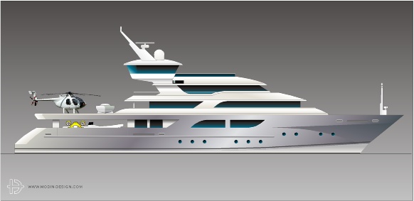

    On this rendering of a 50 m explorer yacht from an earlier discussion, there is an MD 500E, exact to scale.

    Yes my dream yacht design, now i know which Helicopter you drew in, that looks to be a really nice one too, I will have to see how much though they are asking for that model, I just don't want to be getting too high end of one for the usage I think I would be getting out of it. Any idea of the cost?

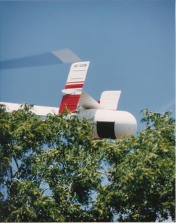

    Great pic and an even better post Garry! I believe this is the MD500 "NOTAR" and they are demonstrating the advantages of the No Tail Rotor system. In this case, partially submerging the boom. In a conventional heli, the results would have been catastrophic!
    Everything about this sytem makes sense. Less moving parts, less exposed (dangerous) parts, more tail rotor authority, better aerodynamics, etc.
    The way of the future? Maybe. Quite surprizing it was not adapted for the new LHX program.

    The police department for Phoenix has been operating a fleet of NOTAR type MD choppers for a few years now. I can tell you they fly with a much lower noise level than a conventional helicopter. One wag compared it to having a vaccum cleaner fly overhead. They are also used for mountain rescue missions. So the control while hovering must be pretty decent.

    Good points Kelly. The NOTAR *IS* much quieter. Also, because they have no exposed tail rotor to tangle in wires, branches etc, they are better suited for low level extraction in mountainous areas. For this reason alone, they are better suited for a yacht.
