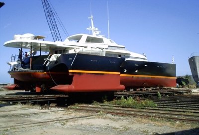

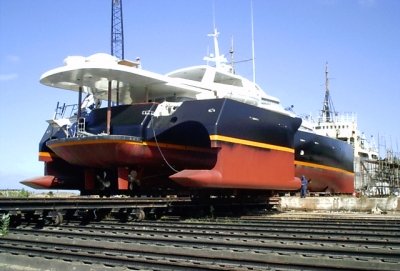

    Gary,
    Today, we had the Captain of Pilar Rossi sign-up as a member, so he would be best qualified to answer the following question. Below are pictures of Pilar Rossi. The tri-hull configuration they are using for this yacht leads me to believe it is not only to add stability, but also to add additional lift and bouyancy... for what appears to be an added heli pad to the upper aft deck. This is only speculation on my part, but I thought it was interesting and somewhat relavent to your question.

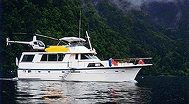

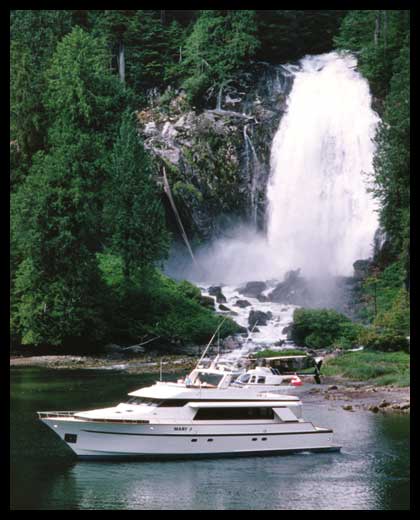

    a picture of a 58' Hatteras MY with a helicopter on the top deck, aft of the fly bridge.

  10. YachtForums
    20,353
    Good Post Mariog! These pictures look surprising, but the weight of a Robinson-22 is essentially the same as the average dinghy.
    The weight of an R-22 (pictured above) is approximately 850 lbs. The only reason I know this, is because I had one. It's hard to remember now, but I think the lift-off weight (fuel, pilot and passenger) was not suppose to exceed 1350 lbs. on the Robinson-22. It's been a few years, so my figures may be off.
    I don't recall reading what Hatteras states as the maximum weight the flybridge aft deck can support, but the most popular dinghy to decorate these boats would undoubtedly be the 13' to 15' Boston Whaler. These boats weigh about 800-900 lbs. With a 50 hp outboard bolted to the transom, this weight would easily be over 1000 lbs. Essentially, about the same as an R-22. :)
    Note to Gary @ ISM: you indicated you're client is looking to land an MD500-E on the back of yacht. This is a substantially heavier machine (1500 lbs+). Loaded with fuel and passengers, the MD500 will approach 3000 lbs. That's a significant amount of weight to place on an aft-deck housing... as well the overall vessel.
    You may want to check with each yacht builder your client is considering. Maybe they can supply you with specs to help narrow down your search, or at the very least, suggest structural improvements to accomodate the weight.

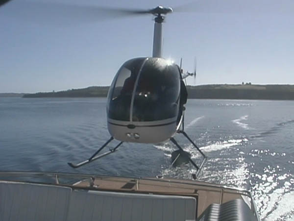

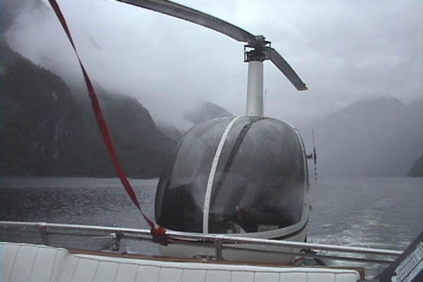

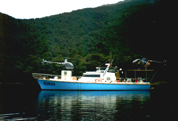

    Two Helicpters
    Lets see if you can beat this one,
    Two Helicpters on a 20m vessel. The takatu is an ex coastal patrol vessel and can handle helicpters as large as a squirrel.

  15. YachtForums
    20,353
    Holy parasite pads! Never thought I'd see an R-22 and an MD500 share a 60 foot boat! Rotors on the front & back. Can you say... Chinook! :eek:

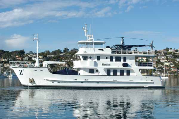

    EnigmaNZ Member
    May 8, 2006
    38
    New Zealand
    Here's another two. Have to say the R44 looks very much at home on the 92' Inace. Not a tidy arrangement, but, well, it is Australian...:p
