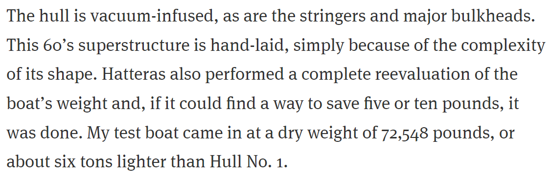

  8. Jpr
    Jpr New Member
    Sep 5, 2017
    florida
    Old thread revival here but was curious to ask. Read two marlin magazine reviews of the GT60, the latest of which seems to imply that there production updates to the GT60 that further reduced the weight of the boat after around 2010 or 11? It would be strange that they reviewed the same boat twice.
