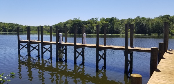

  12. Capt Ralph
    14,501
    Yes, Tall piles are a must.
    When we built our last dock in Satsuma, in normal weather our after deck (where you board) and dock are same level.
    During Storm Dorian 2019, we rose 4 feet. Had 5 more feet to go.
