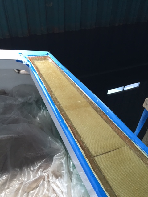

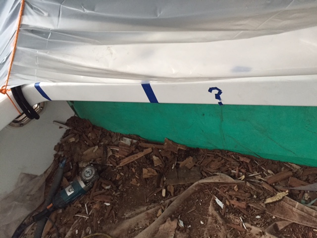

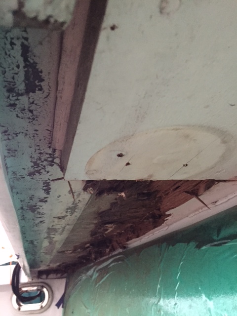

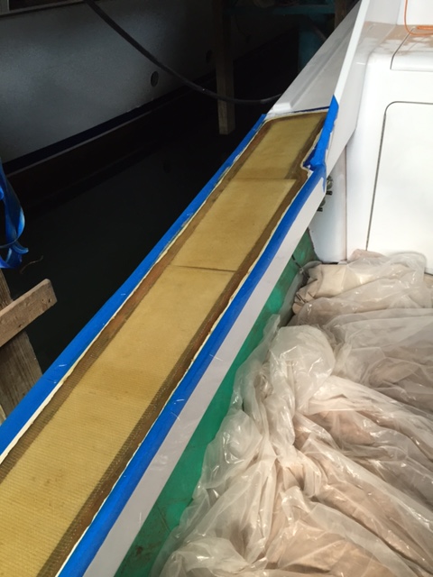

    Well it's turning out to be a bigger job than originally thought. The mahogany was rotted pretty bad and the coring inside the gunnel tops had to be removed. We are reinforcing the bottom of the gunnels with layers of marine plywood that will be glassed in. The only thing that made sense is that the water came in through the rod holders and somehow wicked up between the mahogany and gunnel?

    Holy Cow! JRP you certainly have all my condolences. I went over mine with a moisture meter after your post. Doesn't show anything unusual. Do you think it was your last repair that may have contributed to this.... Looks like the transom top is OK?

    Thanks Beau. As far as I know, there was no repairs done on the gunnels before. The non-skid was redone but that was it. I'm glad to hear yours are dry. I went over the rest of my boat with a meter and didn't find any areas of concern. My starboard gunnel is also wet. I'm going to seal around the rod holders to see if I can get another couple of years out of it.
