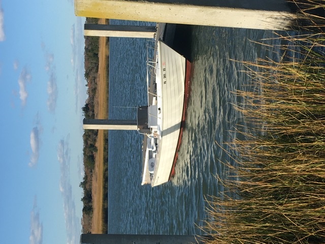

    I run it every weekend and then some .
    New tank installed by me three years ago.
    Condensation water perhaps time for new deck fill o ring .
    NYCAP123 you would like this boat.
    Good boat for racing around Great Bay and fire island etc. good old flounder fishing boat to.

    Definitely a class ride.
