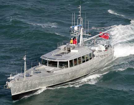

  7. brian eiland
    brian eiland Senior Member
    Jul 28, 2004
    2,955
    St Augustine, Fl and Thailand
    Dashew's FPB
    I find his approch to creating an ocean going vessel to be superb.
    I thought a photo in this thread might be appropriate to draw attention to the subject matter.
    ...and "Why Are We Doing This?"
