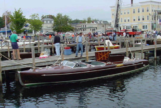

    If you truly appreciate wood on water, than take a look at "Typhoon". I saw this boat on Lake Winnipesaukee, New Hampshire a few years ago, while attending "Woody Weekend". This event draws in nearly 100 classic wooden runabouts from all over the country. Every boat at the event represented some of the finest craftsmenship and restoration skills you can imagine.
    Typhoon was originally raced by Gar Wood. It has been duplicated down to standards so exacting... that new molds were made just to replicate the hardware alone. I don't remember the exact figure, but I believe this was a $1 million re-creation (in 1994 dollars) :rolleyes:
    Here's a link on the history of Typhoon...
    http://www.acbs-bslol.com/Porthole/Typhoon.htm
    Here's the NEW Typhoon. Enjoy!

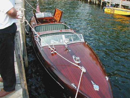

    A top deck, bow picture of Typhoon...

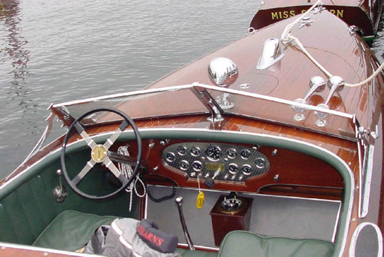

    Cockpit picture of Typhoon...

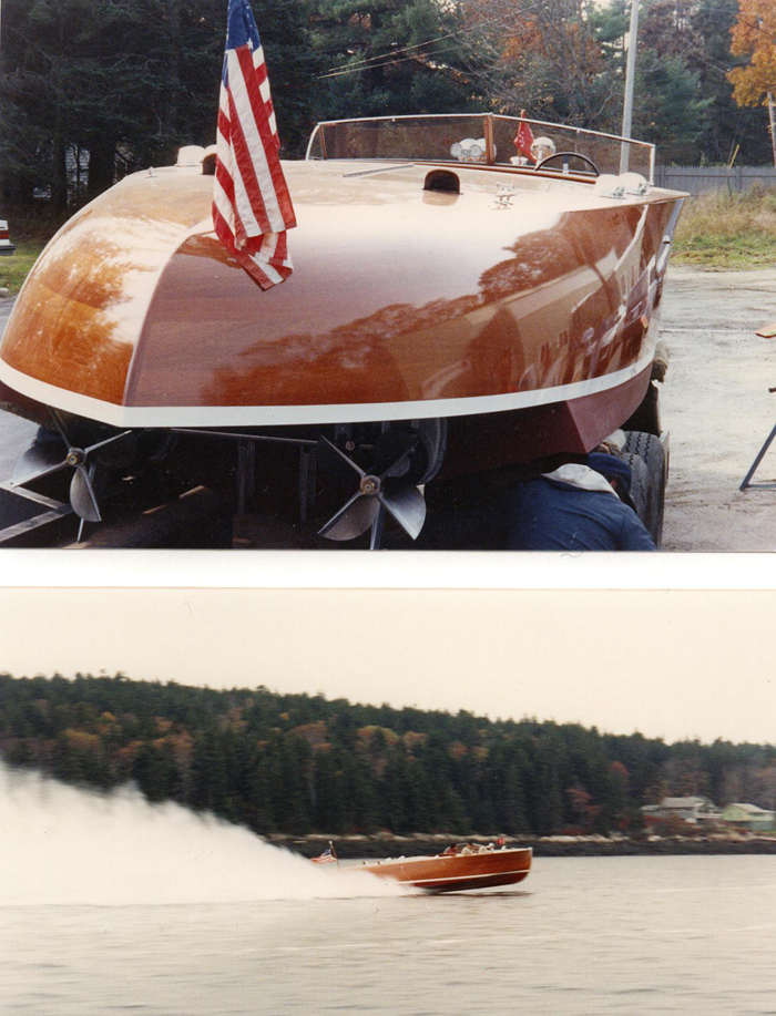

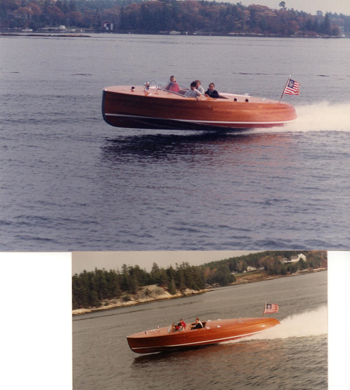

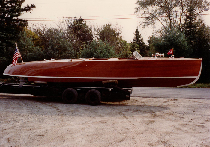

    Here's something similar built about 1990 by Tim Hodgdon, designed by Bruce King and myself.
    31'6" LOA, 25' LWL, 8'1" beam, weight about 6000 pounds, twin 450Hp with Arneson ASD6 turning 17" by 26" five blade Rolla wheels. Top speed 75.3 mph, a hair over 65 knots.

    Shiver me timbers and shake me pine cones, that mahogany is moving! Definitely NOT something you see everyday (any day?)… twin engines and surface drives… on a woody!!! Very, very cool. You go Tad!
