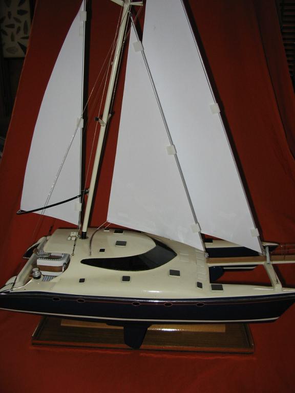

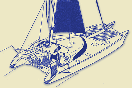

    How about this 'gamefishing under sail' concept adapted from my motor/sailer (motorsailer, motorsailor, motorsailing) catamaran design, that could fish the whole world on its own bottom....not a tournament vessel, but really long range/remote capabilities. And the non-sailer could operate this sailing rig with ease.

    Brian
    It looks beautiful..
    My first perhaps "obvious" question, would be - how dies one "back down" on a rampaging billfish in this beast? (Wait for a change in wind direction?)
    Probably you've thought this thru, so have an answer...

    Yes Trouty, I have given it some thought. My unique sailing rig significantly contributes to the capability to convert to a purely power mode very quickly, and reguardless of the wind direction. And then the widely spaced prop power application makes for superior manuvering.
    Some excerpts from my website:
    Gamefishing under sail? A great majority of the time spent actually fishing is done at trolling speeds (particularly so with the more recent popularity of flyfishing and light-tackle/stand-up styles). This catamaran can reach those trolling speeds under sail alone, in a silent, effortless, stable manner; and without having to use multiple sails. The single central sail (mainstaysail) is all that's needed to reach trolling speeds, and it can be rolled and stowed in 30 seconds or less, while the engines are engaged for exceptional maneuvering while landing the fish for tagging. I'm well aware that once a large gamefish is hooked, the vessel must get rid of all sail quickly, with minimum effort, and get under power. This unique vessel accomplishes that.
    And how about the rigging of the sail plan interfering with the fishing? Not much - look at perspective view. The wishbone boom swings up, to stow totally out of the way while trolling. The entire aft deck is clean except for the two backstays which broadly 'Y' out to either transom. Two short pole outriggers can be swung out from their stowed position up along side these backstays. Its possible that this upside down 'V' formed by the backstays could be rigged with additional trolling clip attachments. The actual configuration of the fishing cockpit area may be altered to suit the owner. Mr. Peter Wright, a very well known name in offshore fishing around the world, has indicated that he would be very pleased to help with the final configuration.

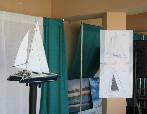

    I'm going to bring this thread up again on the list for several resaons.
    I brought a scale model of this vessel design back from Thailand recently and tried to get into several boat shows (one here and two in Europe). No luck yet finding an exhibitor I might piggy-back onto. I am now actively seeking to get to the Miami show. I believe I can get a spot in the 'strictly sail' portion of the show at the Miami Marina....so that might be my best bet this year.
    But I wonder about a small display spot in the 'Yacht & Brokerage Show' area up on Collins Ave. It would appear my bigger dollar customer would be attending here. If I weren't on a table, I have in mind a 'coat rack' type of display with the 24" model raised up at eye level. Wouldn't take up much space. Anyone down there in Fla have any ideas who I might speak with??
    And secondly, those fuel prices aren't coming down like the old days.

    Miami Boat Show
    I will be displaying the model of this vessel at this year's show in several weeks. I will have a stand-alone spot in the 'strictly sail' portion of the show. Come by and have a brief look, ask a few questions if you're so inclined.
