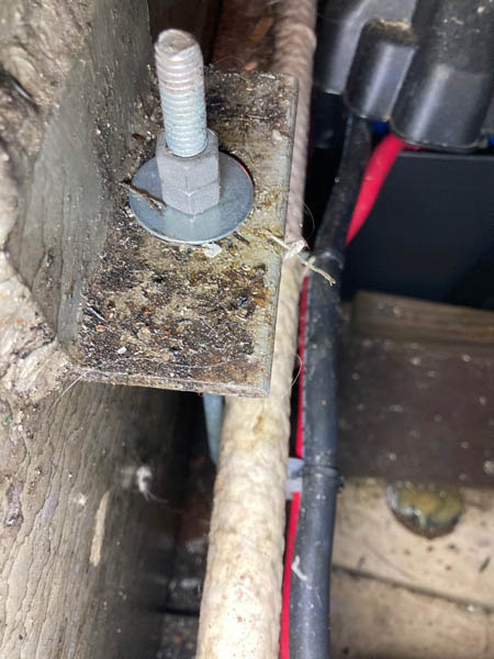

    Heard a new strangle rattle when the CAT tech was over. I couldn't pinpoint the source but he was able to. One of the forward fuel tank L hold-downs had failed. It corroded through right at where they bent it when new and the galvanizing had fallen off. Easy fix with galvanized L bolt normally for imbedding in concrete to hold base plates. Shortened and threaded the other/short end of the L and slipped right into place.

    Maybe some Teff-Gell or nylon washer and band on the threads keeping the 3 different metals apart.
    Nylock nut on the other end?
    You will never have to think about it again. Unless your going to update the other capture points.

    Locking nut on bottom/bulkead side. Original was double nutted but that makes the short part of the L too long to fit between the tank and bulkhead to install. I'll replace the other side next time I need to have the batteries out as need them removed for access.
