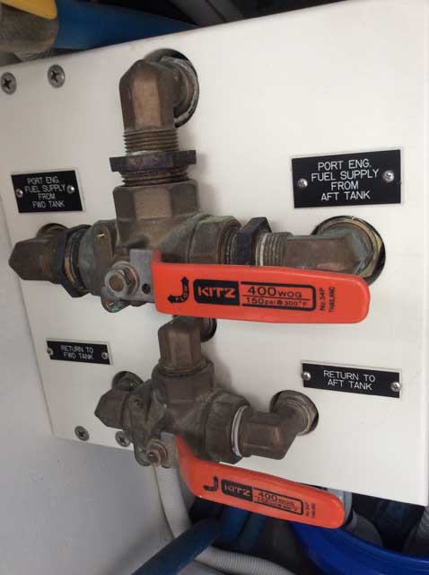

    Couldn't figure out how to post a picture. I sent them to carl@yachtforum and hope they get on. Beau description looks right. Still not sure if I'm running on aft or forward tank.

    sounds like you are running off the forward tank. If you have found the adjustment valves, 2 of them, one supply one return, you can try turning the handles to their opposite positions, and see if you draw off the rear after you trace the fuel lines. If you are set up like mine, you will now draw from both tanks.

  20. YachtForums
    20,353
    Here is the image I received from Dennis, resized for YF...
