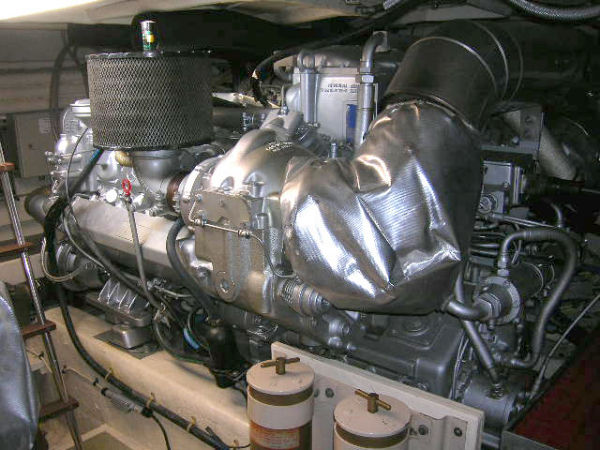

    here is a picture of my port side engine with the filters on the lower right, not a very good picture but I need to check and find the gauges
  16. NYCAP123
    11,205
    You have got Racors. You would do well to change the T-bar for a guage. RU finding much gunk in the bottom of the Racors?
  17. Pascal
    8,162
    actually on dual racors, the gauges are on the cross pipe next to the valve, between the filters, NOT where the T bar fits. the gauge might be just beyond the edge of the pic.
