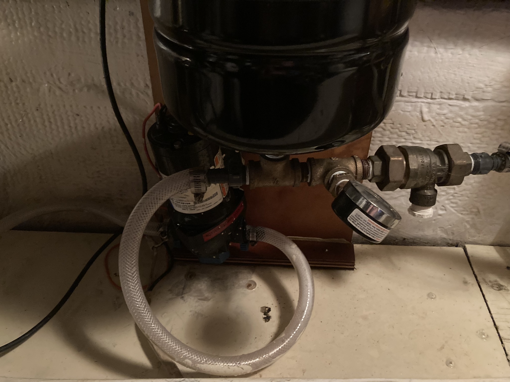

    No noticible change in flow before the pump kicks in. With the old lower pressure/probably dying pump and the PO not charging the accumulator there was a noticible drop. There was enough label to read the p/n (1ET2G12F) so could verify the accumulator is 2 gallons. It's now pre-charged to 35 psi, 5 psi below the pump switch-on pressure.
    Here is how it is plumbed (picutre is old pump).
