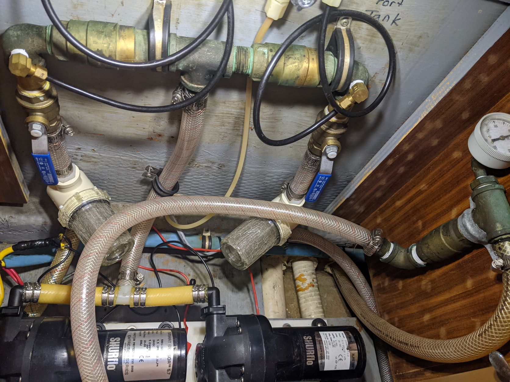

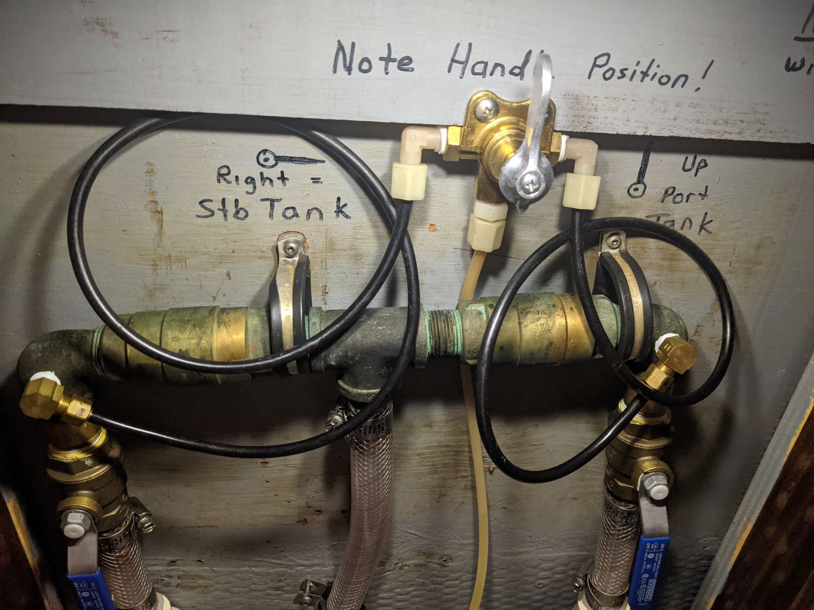

    I am prepping for a new 24V Headhunter fresh water pump and I was looking for recommendations for inlet filter/manifold/plumbing recommendations? My current set up has a manifold for allowing water to enter tanks from a water maker that I removed and probably wont need for quite a while. Should I replumb and try to get everything down a little lower for better flow? What filters do you like? Best base material for new pump? Isolation mounts for board and or pump? Any and all recommendations welcomed.

    They are loud and sometimes they get stuck in a very slow flow requiring the water be turned on so they will go to a higher speed and then cut off. Today I did turn up the STB unit to 50psi shut off and that helped, I need a small l shaped screwdriver to adjust the other unit.
  5. Capt Ralph
    12,711
    Sounds like you are picking up air. Raising the cut off pressure is a quick way to cure it on a diaphragm pump like the Shurflo (and others).
    The HeadHunter pump will give you more grief if it picks up any air.
    Headhunter pump may need to be installed below the tank level to to reduce these issues..

    Thanks for all of the comments. I do believe we are picking up some air. Now that I think about it the air issues started after going back and forth from using pressurized dock water through my cockpit inlet and then back to water from the tanks. I would say those filters are definitely right above my tank level. This is on a 1986 Hatteras 52c. I do have a accumulator tank in the system.
