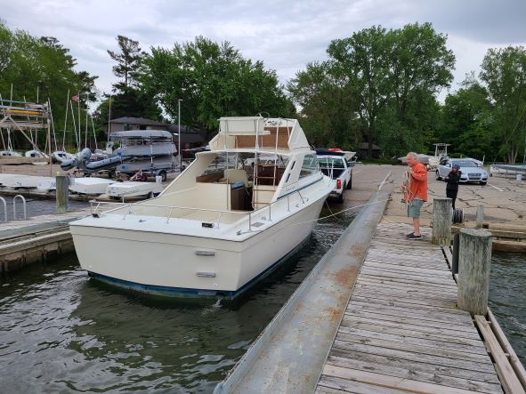

    Not a barn find or an impressive restoration, a fairly common boat, but this one was never sold. It sat in storage in Sturgeon Bay until 2020, when I brought it home to where it was built, Holland MI. It still has the seat cushions wrapped in plastic from the factory. The gelcoat is a bit faded, the dealer never polished it because it was a "new" boat, and he didn't want to wear the gelcoat. The engines have 500-hours on them, standard Chris Craft 350Q engines, but with original full freshwater cooling, including the exhaust manifolds.
    The boat is far from perfect, seems like a 5-year-old boat, with some scuffs and marks here and there, a few chrome pieces showing age. 47 years as a dealer demo I guess.

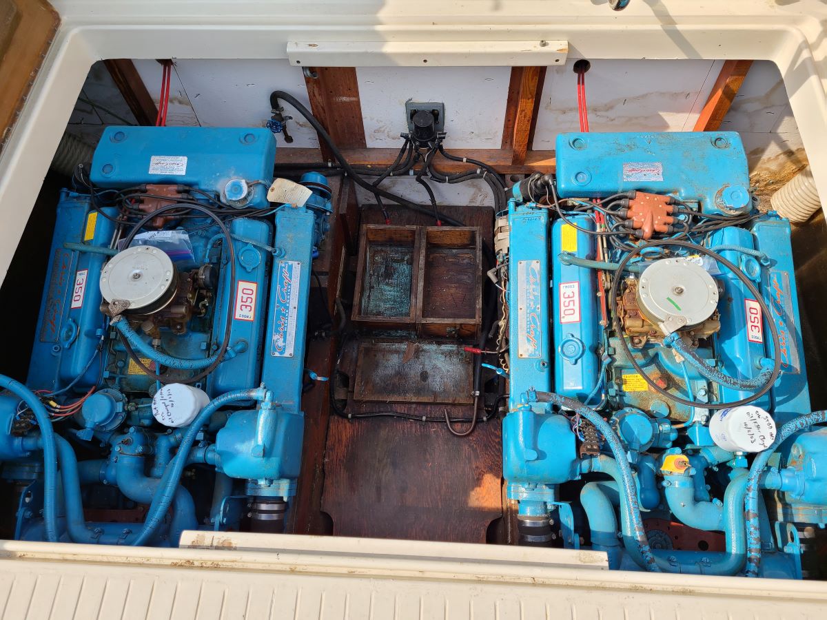

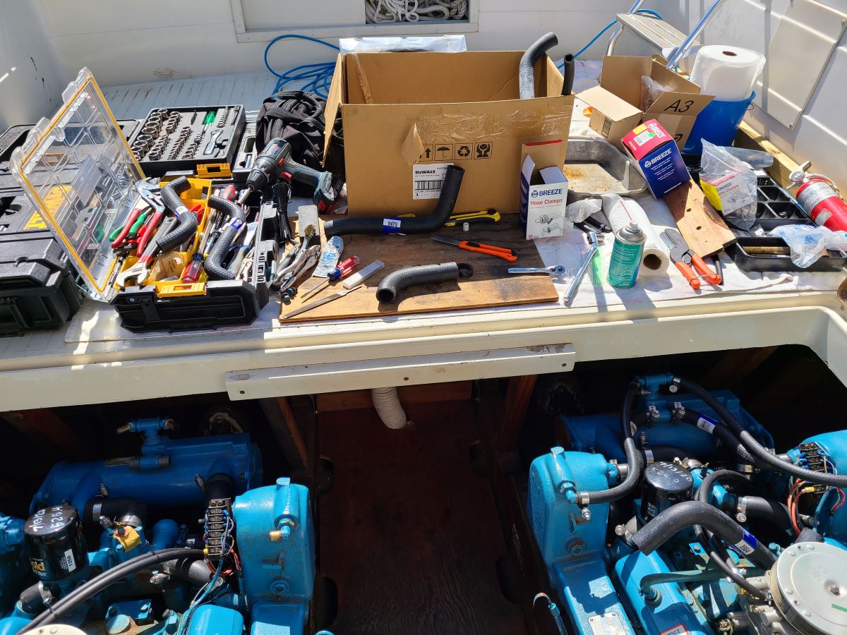

    I expected the engines and fuel tanks to be rotten after sitting decades, but noticed the engines had maintenance tags, with a long string of dates and initials, indicating they had been maintained. The raw water pump belts were off, indicating they had been getting turned over in storage, like a museum piece. The engines are perfect, compression better than factory specs. The fuel tanks are perfect inside, shiny and clean after I siphoned out the old gasoline.

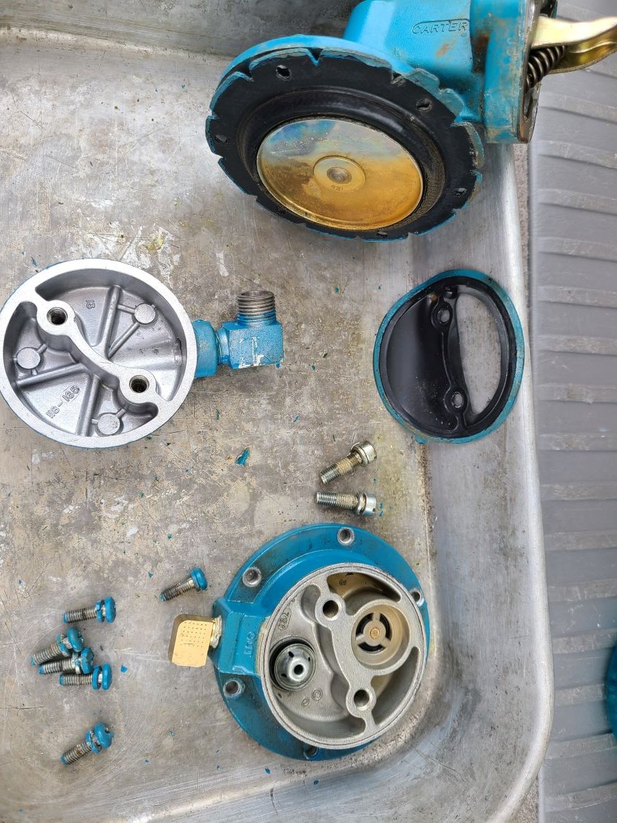

    Every rubber part was suspect, even though they looked and felt great. The fuel pumps had bad rubber diaphragms, were leaking fuel into the crankcases, and no rebuild kits were available, so it has electric Holley pumps now. I had to replace the old Carter carbs with Edelbrock, built by the same company and visually very similar, the engines run great. I made new fuel, coolant, water, and exhaust hoses, with over $1,500 in constant-tension stainless hose clamps. I enjoy this kind of work, and spared no time or expense. I worked as a kid at a marina right down the street from the Chris Craft factory that built this boat, worked on a lot of old Chris Craft, and still love this kind of work decades later. There is a lot of expertise in this area to advise me, I know several guys who worked in the plant when this was built, including Chris Smith.
    Changing the prop log hoses and cutlass bearings required taking the props and shafts out, and dropping the struts. I took the props to a local shop that has been working on Chris Crafts from the local plant since forever, they were giddy to see like-new props from '74. They polished and balanced them, didn't need much, and the shafts were dead-straight.

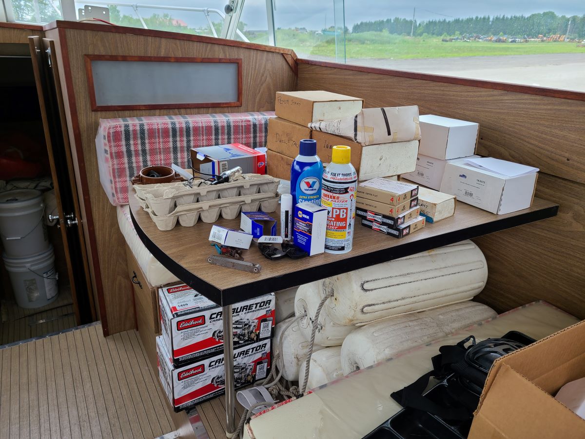

    Everything went back together well, better than factory now. There are still a lot of small things to improve, but it is running great. The son of the dealer sent me a box with the radio and depth finder originally installed by the dealer, they work like new. Summer of 2021 I used it as a day boat, idling around with friends and family. I've been reluctant to change anything, but I finally took the old toilet out, added battery switches and a charger, it is time to modernize and enjoy this boat as it was intended. I might even take the plastic off the seat cushions. I'm still resisting painting the bottom, the original copper is green patina, I love the look, it just feels old and right.

    The crank cases were very over-filled with foul-smelling oil, that was my clue that both fuel pumps had ruptured diaphragms, raw fuel was filling the crank cases. The engines had definitely been run for some amount of time that way, after sitting a very long time. It could have ended badly if they had run it long enough. The fuel had lost most of it's volatility when I siphoned it out, saving grace perhaps.
    It appears no harm was done, compression is excellent, and top speed is 35mph as it should have been new. It is getting plenty of TLC, I still have my father's old tune-up equipment I used in the '70s, still able to find parts I need new.

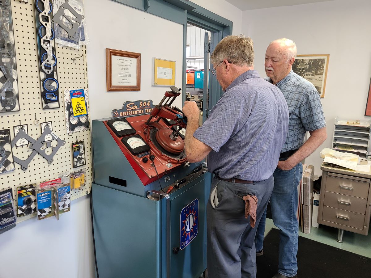

    The running gear still looks and feels mostly near-new. The distributors are probably the weakest link I can't get new, so they get a mist of WD-40 any time they will sit. The springs and weights tend to rust from the crankcase venting through the distributor, kiss of death for a lot of these old Q engines. I'm slowly taking things apart, checking, measuring, polishing, and putting back together better than new, but mostly as original.

    About the distributor and the WD40: It's an OK penetrant, but a lousy lubricant or preservative. I used to free up the shackles with WD40 every week on a yacht I raced on many years ago. Finally I began to wonder why it was necessary if it was all done a week prior. The answer is that it evaporates over time and offers no protection. I switched to Boeshield T9 and I went from freeing rusting shackles to checking for continued smooth operation. T9 doesn't last forever, either. Corrosion Block and similar will do a better job.

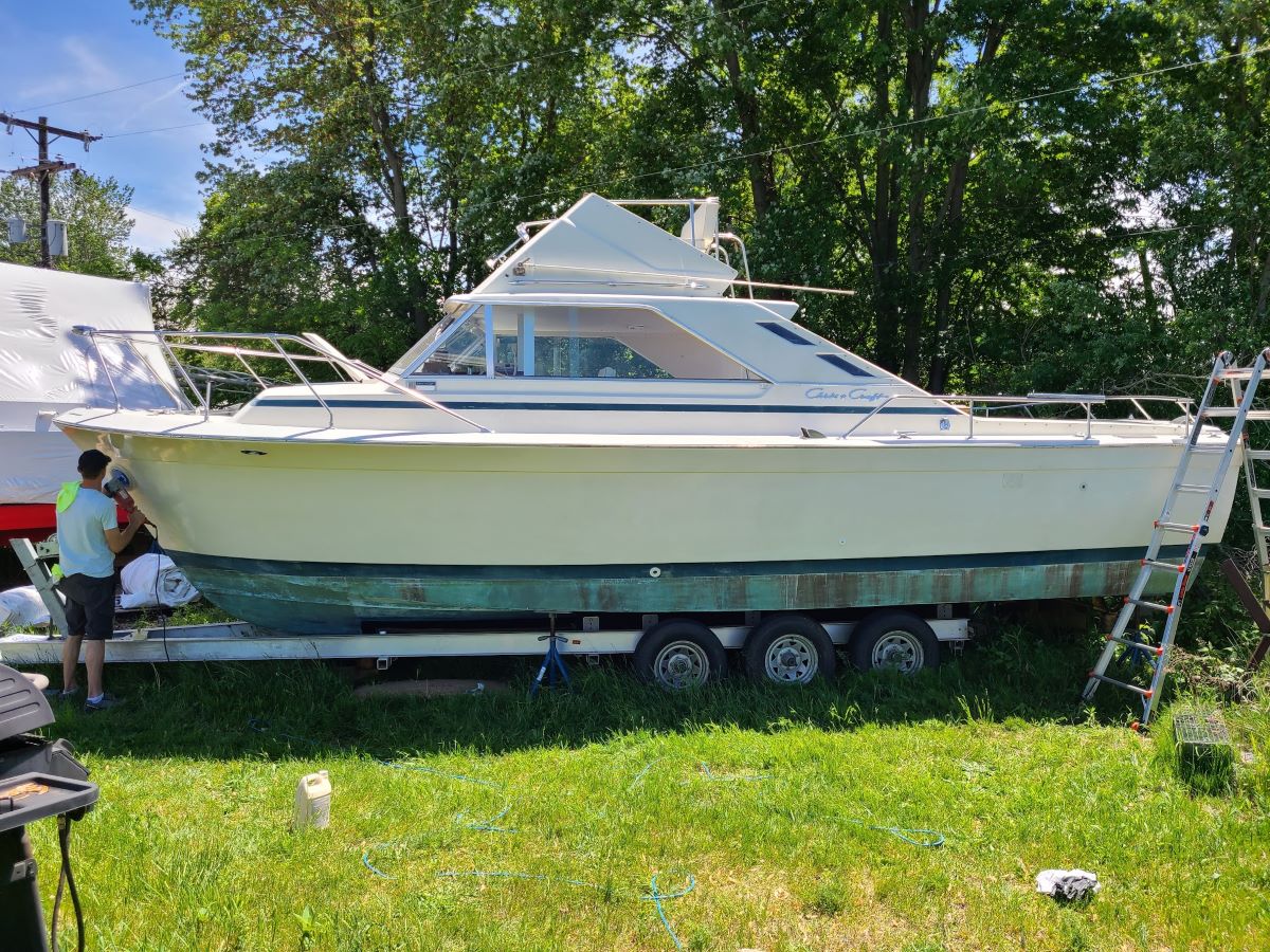

    You've got a cleanslate there. Boat is perfectly Original. Rub rail and hull look perfect and straight. No dings in the rub rail . To me, an perfect candidate for a few cans of Interlux Perfection Oyster White. Just a light sanding is all that is needed for this boat. Roll and tip/brush the bridge first , cabin top to the blue boot stripe as a break point, then the forward deck and gunnel. Then the hull from rub rail to water line.
    Two coats...done. No primer needed. The boats gel coat is the same color as Oyster White. You can spot prime spots you have to fill in or small cracks or scuffs with Interlux InterProtect 2000e white as a fill and primer.
    Same paint for the boot stripe and water line. Only blue.
    Paint and supplies around 1k. Your time...all depends. On and off ...,three weeks or so to get it done.
    Have a good yard paint it...., $30k , my guess. NUTS. Won't look much better, as long as you or your friend is a good marine painter.

    Thanks, maybe a good idea for winter layup. I use T9 elsewhere, it leaves a waxy film that might build up with frequent us. Probably the engine heat would melt it and sling it to the sides, and it would run down to the crankcase, but no telling where it might build up if used regularly.
    Normally distributors don't need lubricating, and don't corrode, they stay slightly oil from crankcase fumes. But in a marine environment, there is more moisture travelling into and out of the engine when running and cooling off. WD-40 is particularly good at displacing water, which is what I'm after, and it will last a long time in a closed distributor out of the weather.
    Somewhere on YouTube there is a video of someone spraying WD-40 into a distributor, then closing it up and trying to start the engine. The small explosion that followed is good warning not to spray it before starting.
    My engine gurus:

    The boat sits beside a very high-end restoration shop, full of classic Hacker, Ventnor, Garwood, Chris Craft, etc. They have a gelcoat guru who comes in for special fiberglass work, he checked out my boat and was much impressed with the condition of the gelcoat. I paid him to buff the hull for the first buffing since it left the factory, it came out gleaming. I think I'll stick with the gelcoat. I do need to repaint the stripes and trim, and some interior bits.

    Yes, yes ! I agree. Looks great. Hit the blue. Petit or interlux brightside would do the trick. Two coats with a Jen Poly foam brush and done. It will last years. No need to go crazy with two part stuff for that.
    Love all the S/S railings ! Nice looking and great for safety. Plenty to grab a hold of... Seems to be a forgotten item with new boats today. Boat really looks new. Windows are really in great shape.
