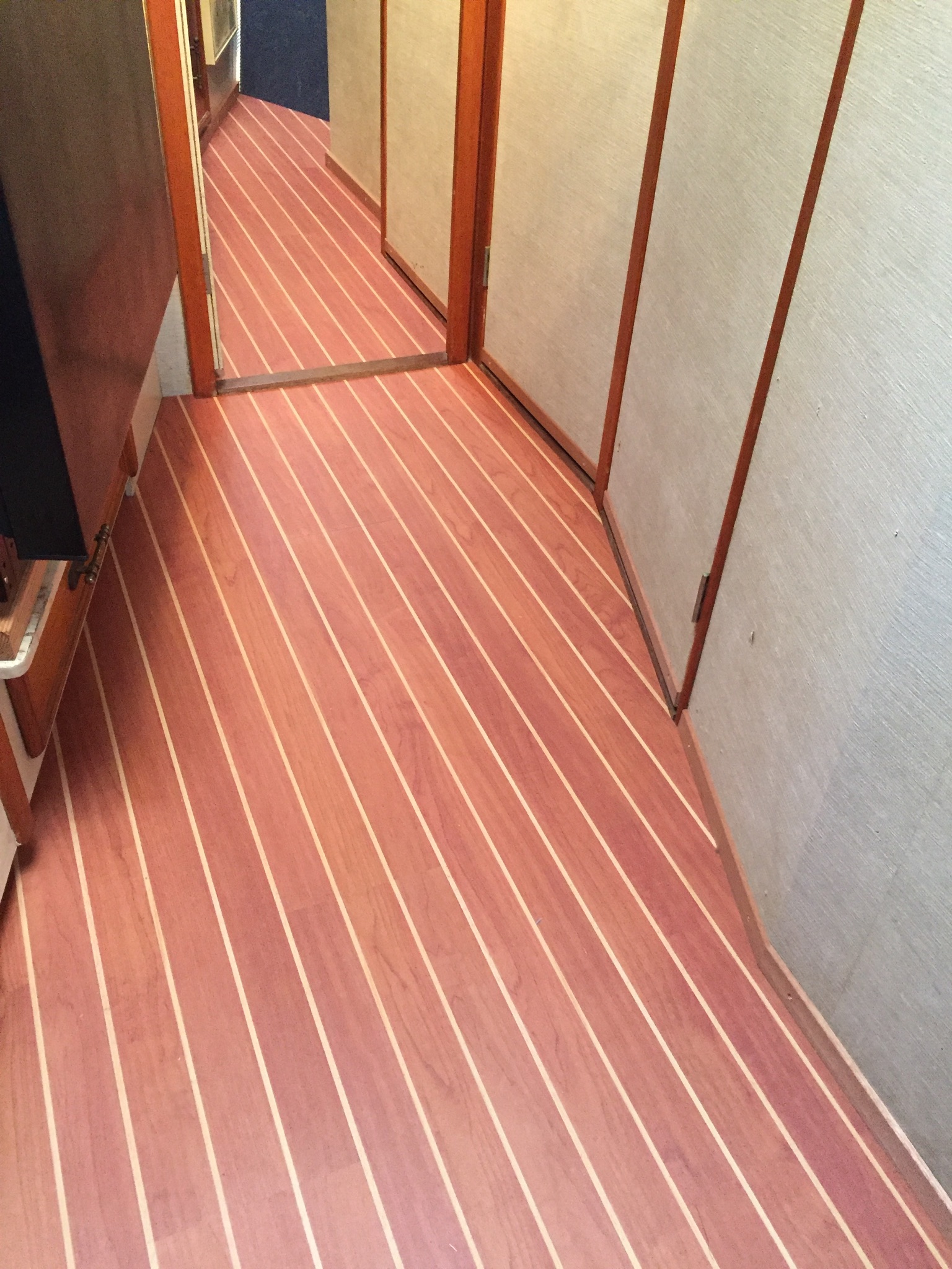

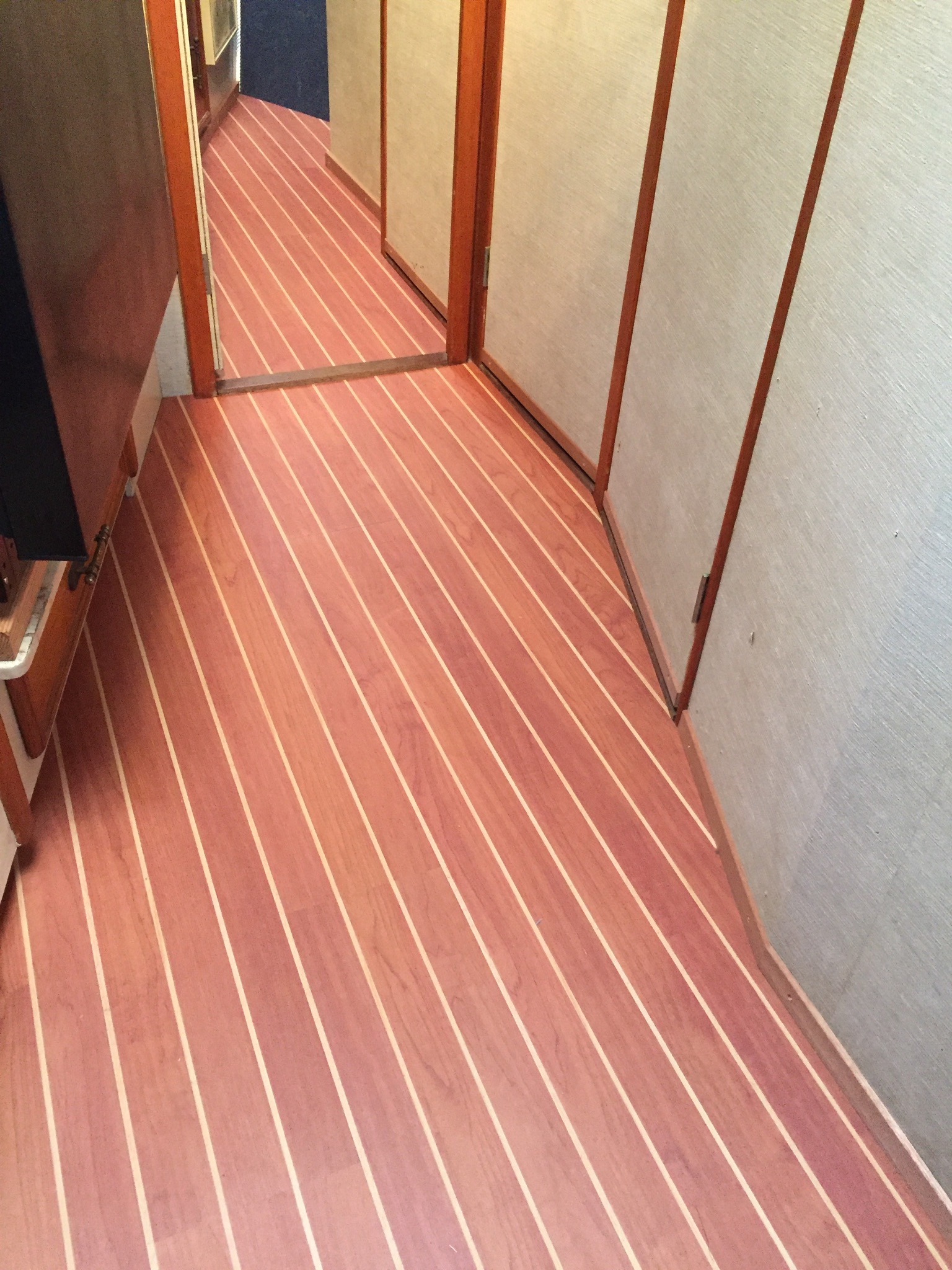

  6. Echomajik
    Echomajik New Member
    Apr 3, 2016
    10
    Montauk
  7. OutPost
    OutPost Member
    Jul 26, 2016
    73
    Long Island, New York
    Looks great!
    Your fridge install looks a lot like mine before I got it finished off. I wound up building a platform as well to make it higher so that I could get more depth as the fridge hole gets deeper as the hull rises. Looks like i went a little higher than yours. I wound up cutting out the back of the fridge hole near the top with a sawzall to get the full height, top of my replacement fridge is right at top of hole. It was a lot to cut away .. Post really has wood and bracing everywhere. I don’t seem to have compromised the support of anything above though and now my replacement fridge, which was standard appliance store size sits flush. I forgot to take a picture of the trim I made for the bottom before putting her away for the winter but I will soon and post.
  8. mwwhit1
    mwwhit1 Senior Member
    Jan 19, 2006
    239
    a
    Was just at the Palm Beach boat show yesterday and picked up a sample of Plasteak vinyl sheet. Want to put it in the head. Seems easy to cut with a razor blade and glue to the subfloor. But I think I see seams, so you have the click\lock one? Is that teak & holly satin? That is what I was looking at. Thanks, Mark

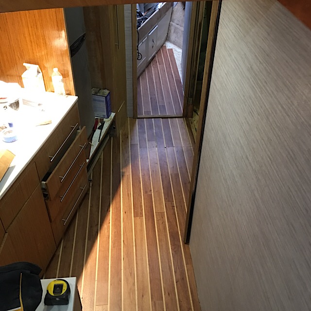

  9. Daniel Walker
    Daniel Walker Member
    Nov 16, 2015
    65
    New Orleans, La
    I ended up going with Amtico, I believe this is the same product that Viking uses in current builds. Here is a pic of mine going in. I can recommend a distributor if needed. IMG_3061.jpg
