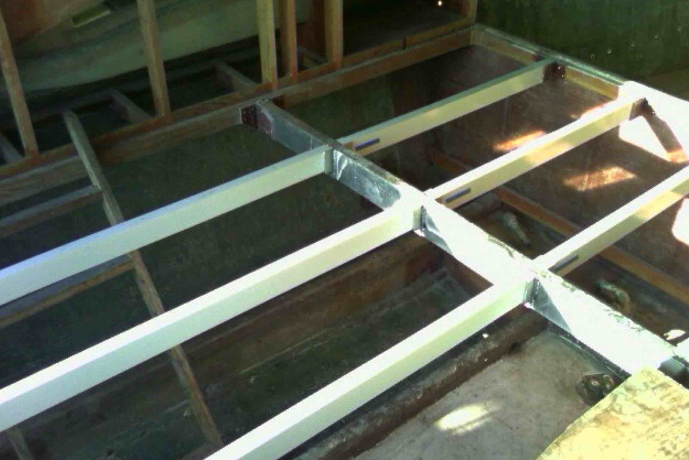

    1,164
    In The Bilge
    Bedford reinforced plastics supplied all of the FRP structural shapes on a total gut machinery space refit a few years ago. I checked multiple suppliers at that time and found Bedford to be the most reasonable price wise, delivery schedule and OTG shipping expense. I used FRP products from Bedford for the engine bulkhead furring, engine room decking sub frames 2 x 2 x 1/4 pro-form L angle and 4 x 4 x 1/2 wide flange beam for the ER overhead beams /main saloon sole soft patch. FRP pricing is or was similar $$ to aluminum in 2018 with three times the load strength. Photo is of the ER decking sub frames. Google Bedford Reinforced plastics and look at their "Pro Form Shapes" section for product info, sizing and price.
