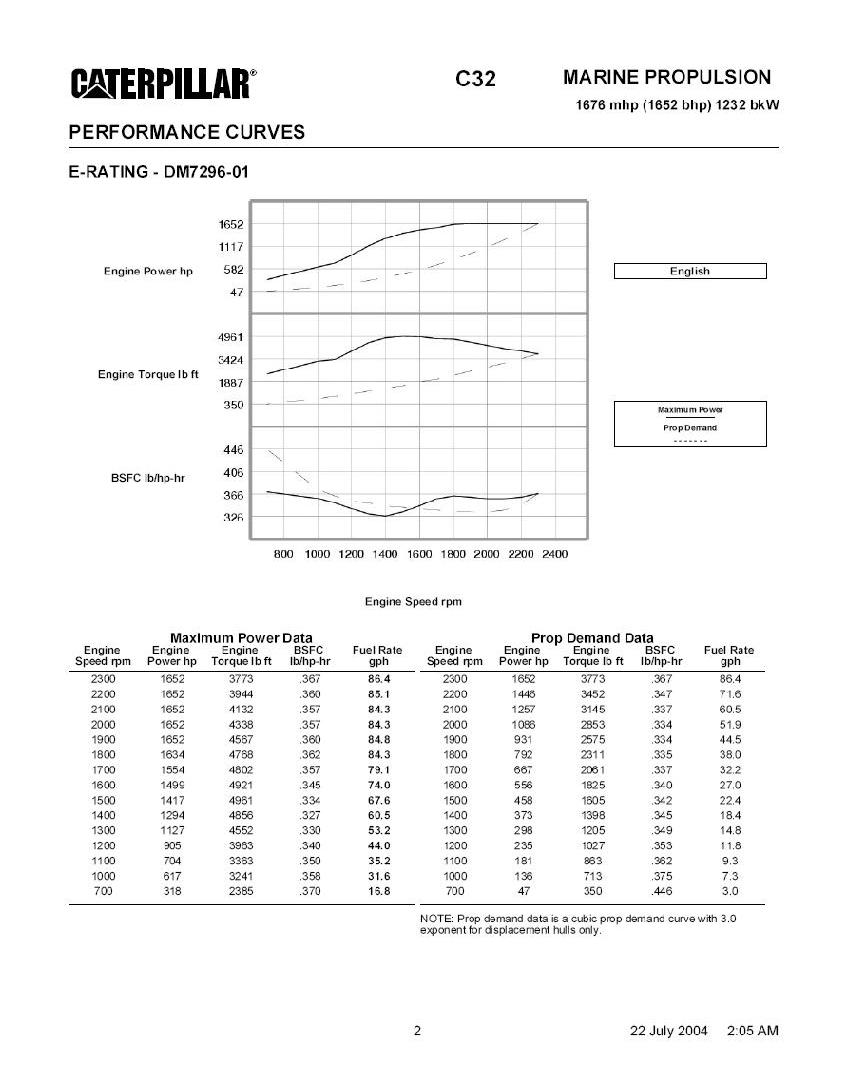

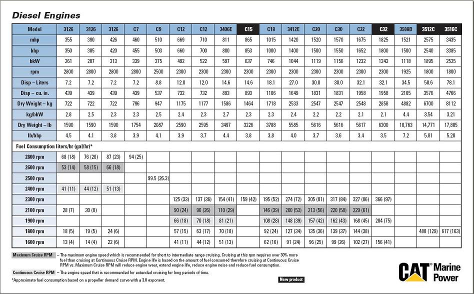

    Found this.....don't know my boat's speed though at the various engine speeds.

    For the C32 (1675mhp) Diesel Engine and mine even have less output (1572mhp):
    @ 2100 rpm ==> 11.6 hrs
    @ 1900 rpm ==> 15.8 hrs
    @ 1800 rpm ==> 18.4 hrs
    @ 1600 rpm ==> 26.0 hrs
    Any idea what the boat's speeds would be at the above engine speeds?
    Thanks in advance.
    TK

    Do you have a C32 power curve handy ? (I'm at home and cant find one on the net) We could do an approximation from that.

    Thanks again CODOG......here it is.
    The C32 has a flat power curve between it's vessel cruising speed of 1,900 rpm and its maximum speed of 2,300 rpm.

    Hi TK, the endurance figures youve quoted and the power curve you posted are for the C32 @ 1675mhp. You actually have the 1572mhp rating so any speeds I estimate against these rpms wont be accurate.
    Also, the endurance figures above are based on 100 % of your fuel capacity and using a displacement hull prop law curve which will give better range at slower speeds than a deep-v hard chine hull. You wont be able to achieve those hours at those rpm in reality, although its not a million miles away. When I get a minute I'll dig out a power curve for your 1572mhp Cats and do a bit more of a calc, but in the meantime I'm still happy with the ranges I estimated at the speeds you asked for.
