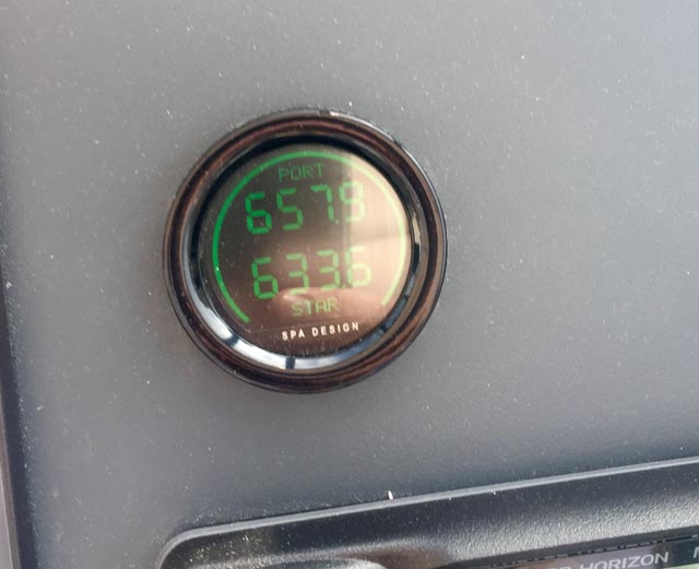

    Take a look at the Spa Technique gauges, installed the Dual EGT gauge couple years ago and very happy with it. Stainless probe that mounts in the elbow. Easy connection. They also make a boost gauge. I looked at the two you mentioned and this is far superior.
    You can buy a separate sound alarm, but can set up gauge with color flashing and specify warning temps. Good company to deal with as well.
