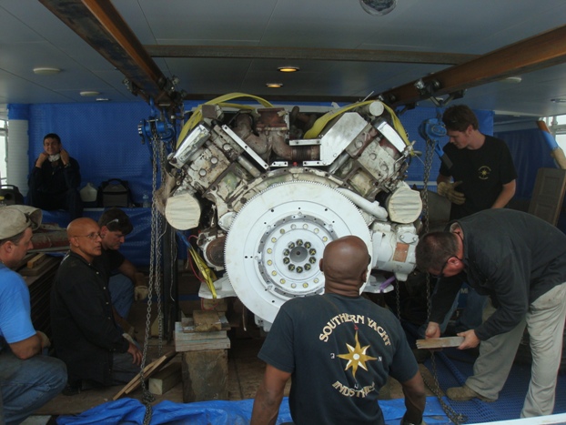

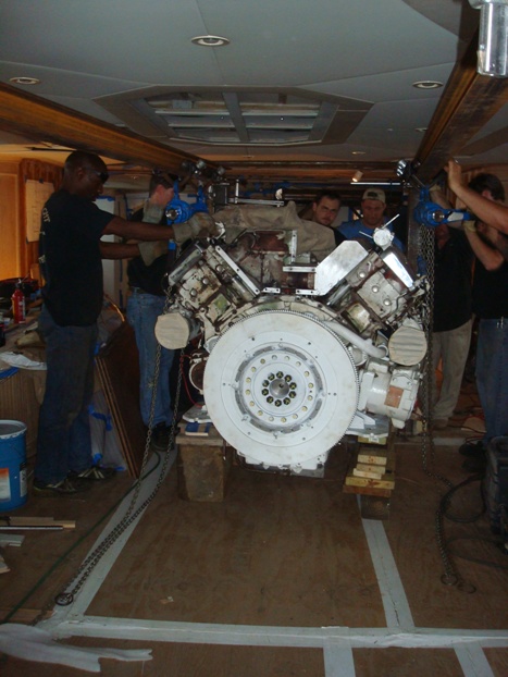

    Sometimes it's a tight squeeze but the right people can make it look easy.
  2. Capt Ralph
    12,727
    You're not in south Georgia!!!
    It's good when a good plan comes together. By the head count, it took near all of them to pick it up.
    At the end of the day, no damage to the ship and all go home with the correct digit (finger) count, It was a good day.

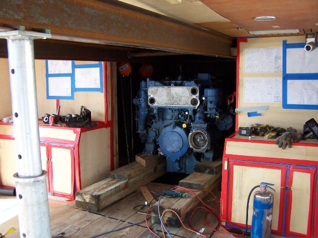

    I am imagining the effort needed just to prepare for the main job.
    It looks like they've taped luan or underlayment to all the cabinets and walls for protection against a misguided wrench.
    Lots of planning before you even set foot inside the boat.
    Is that a camera above the counter in the ceiling or a light fixture ?

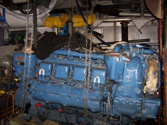

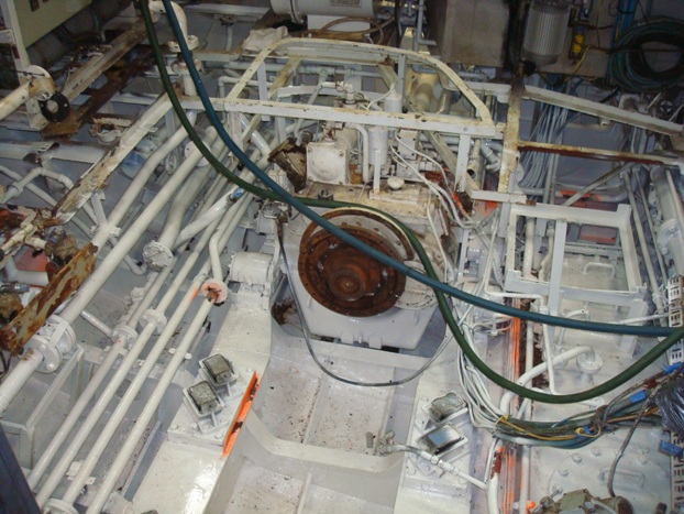

    NO, the blue one was just a "normal" engines and generators upgrade. The gaping white cavity was left over after removing the engine because some clever fellow thought it was OK to place the main bearings in series with a welding ground.

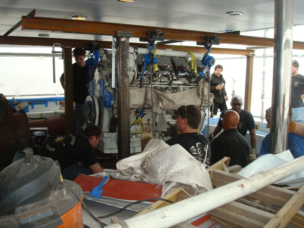

    Ready to lift:

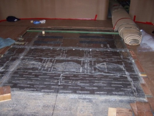

    Ready to Close up:
