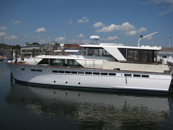

    In 1969 we were visiting a marina in St. Charles, MO and they had 6-7 men working feverishly on a 57' Connie. She had developed a leak and sank at the dock due to the engine room portholes being open. The boat belonged to the Busch family and they made an annual pilgrimage to Chicago on the boat to attend the Bears/Cardinals game, hence the worker's haste as it was getting late in the summer.:cool:
    The picture is a sister ship........

    1,058
    ddw1668,
    is the engine room that far fowrard in that Connie?
    the port holes do seem a little too low for my comfort

    I cannot say regarding the Connie, however on this Roamer and others I see the engine room is definitely that far forward. The aft bulkhead of the engine room is the same as the entry way door bulkhead. Which by the way is just forward of the helm.
