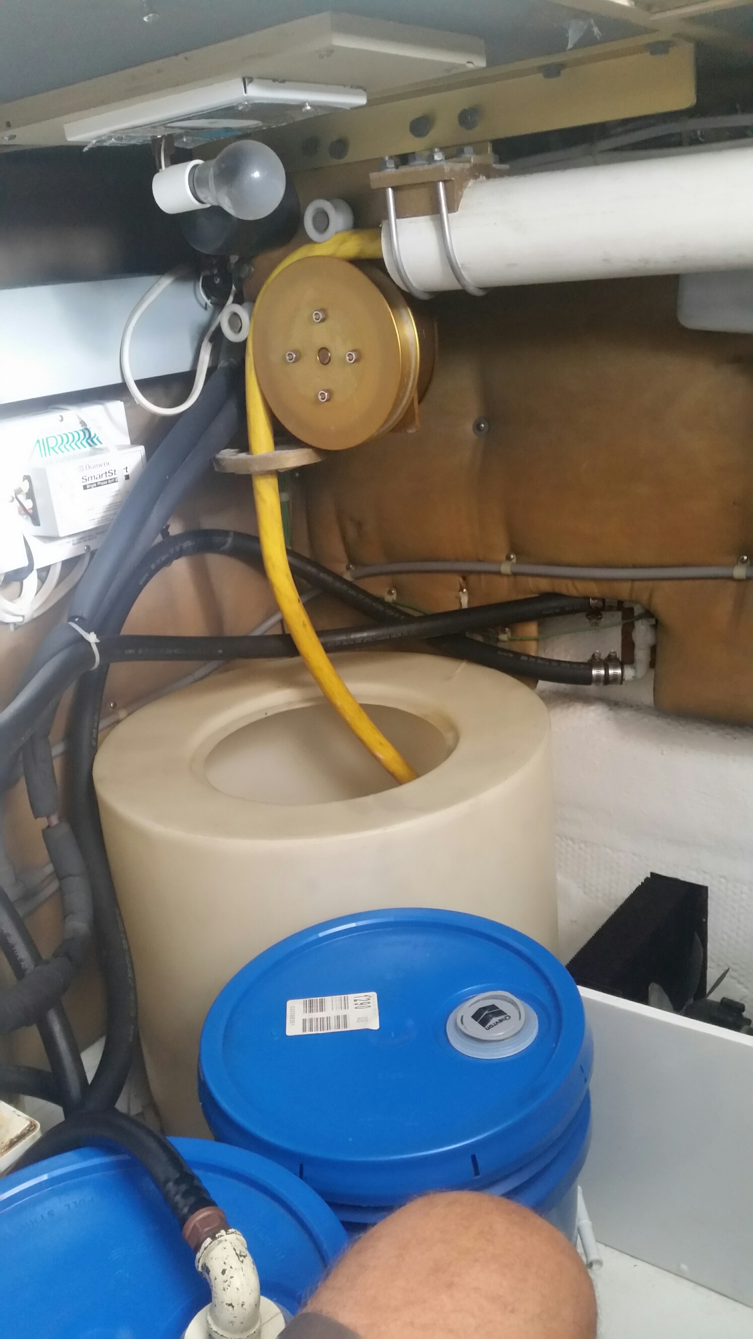

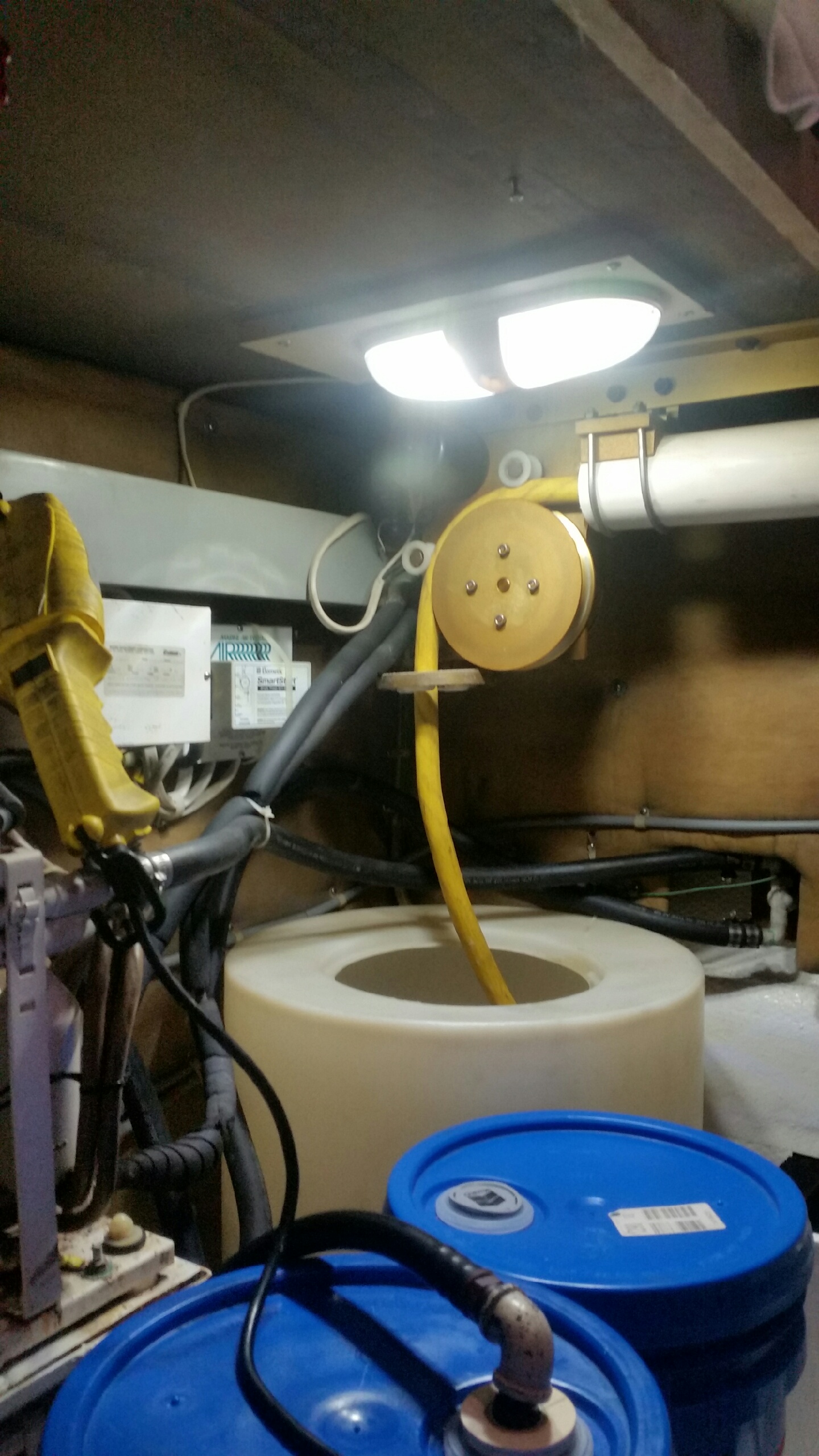

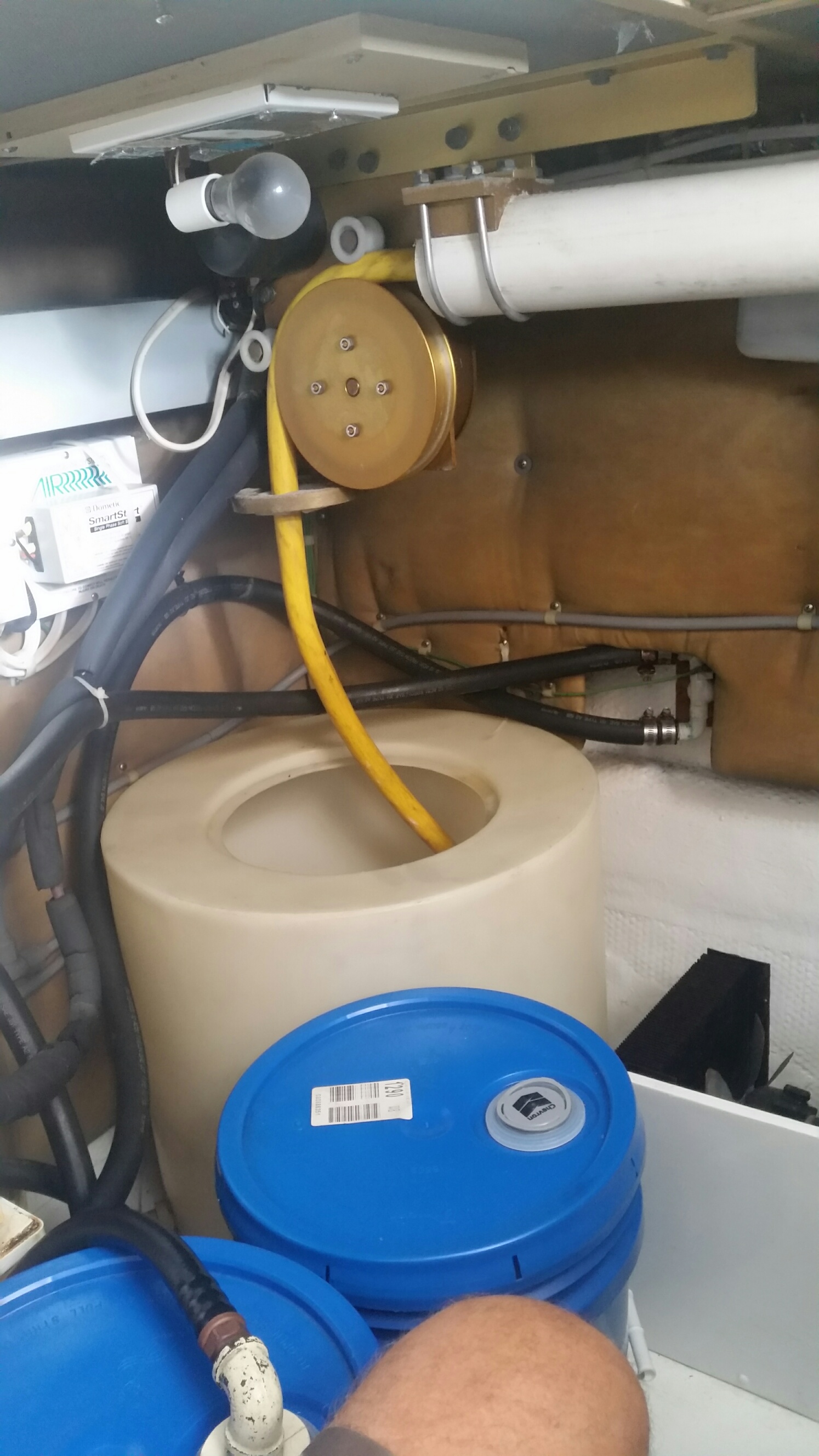

    From this to this: 20161214_113616_resized.jpg 20161221_162604.jpeg Lower power, cost and heat with brighter white light. Controlled with original engine room switch plus dual switches on the unit. Great addition with four total installed. Thanks Bamboo and the rest of you guy's
