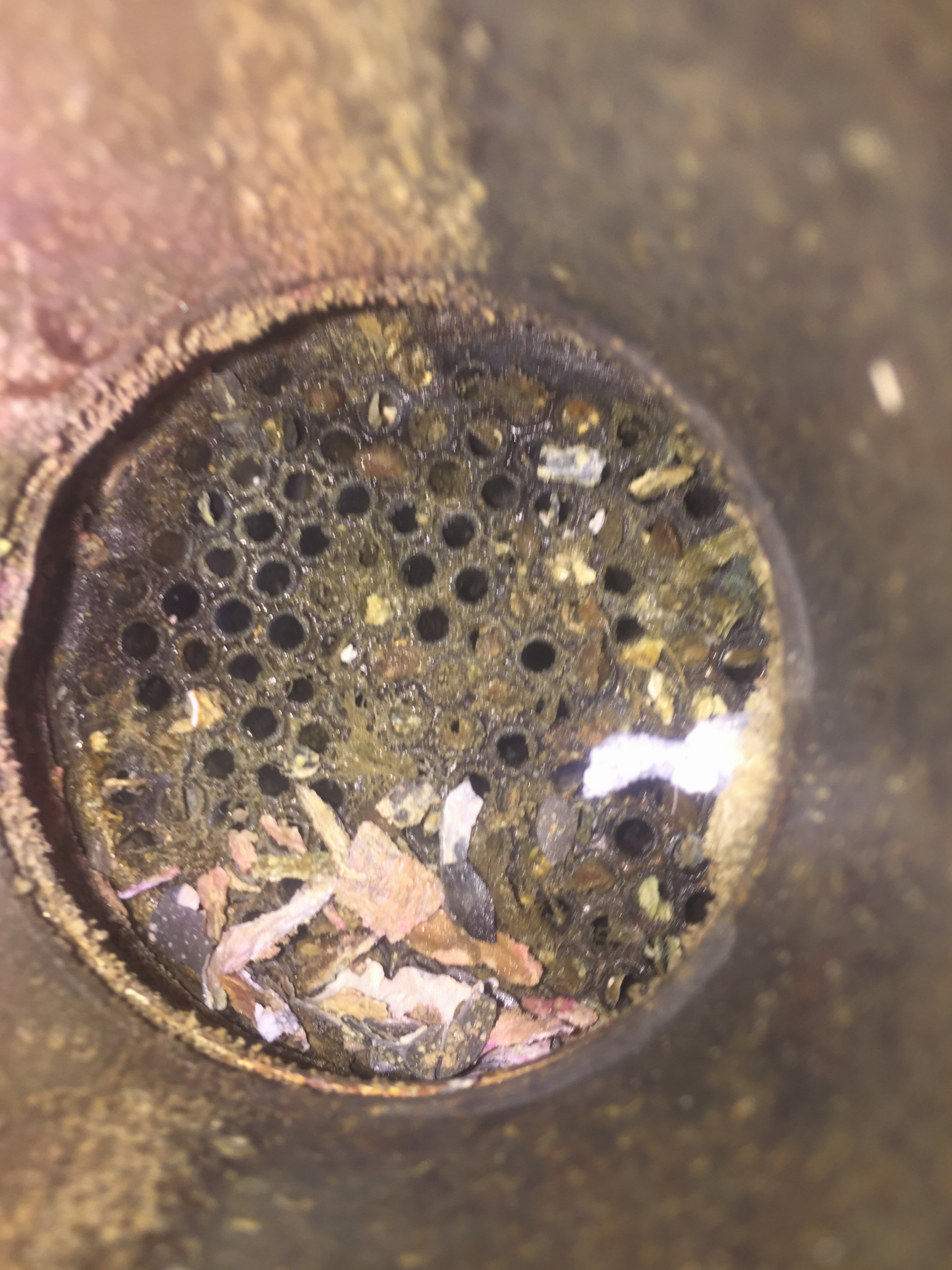

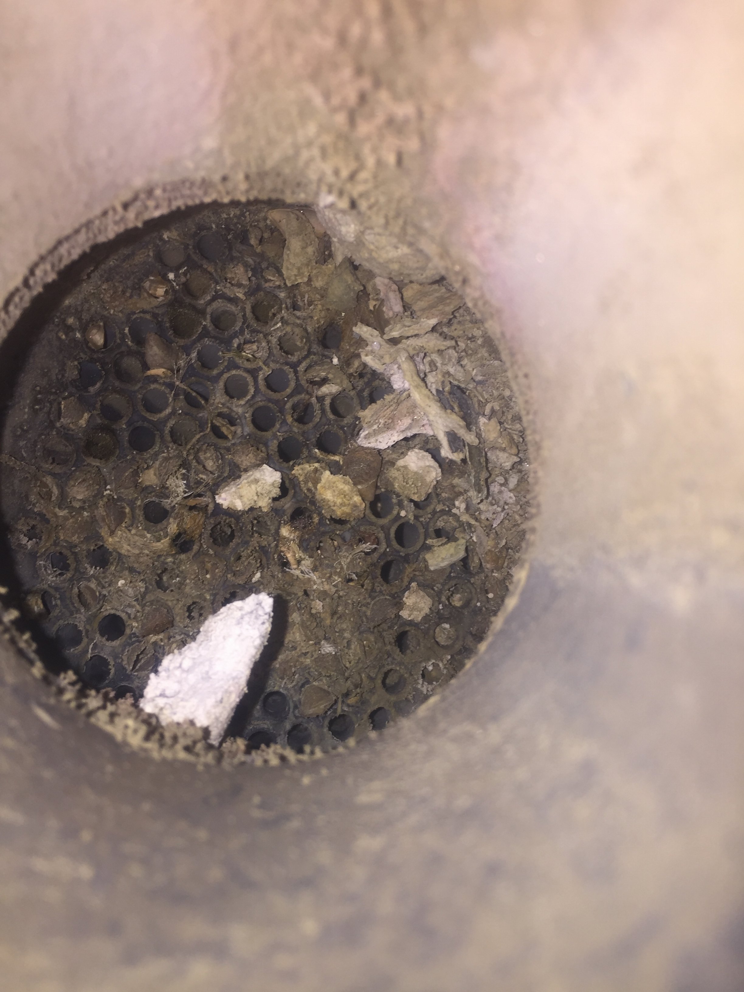

    Has anyone replaced the raw water intake hose with Silicone? I finally ended up cutting off the hose to get the tranny coolers off, the hose was old and wasn't playing nicely.... From the appearance (See pic's attached) it's been a while since they've been cleaned. Does anyone know if there were bonding wires that went to these transmission coolers on the 6-71TIB. The reason is I found a bonding wire on the engines heat exchanger, having those cleaned also! They were bad, but nowhere near like this
    My rear Zinc plate is about 1/2 gone- normal consumption based on my 42 which I could get two seasons out of one. Shaft and Trim Tab Zincs are about 1/3- 1/2 gone also.
    I'm going to be checking the zincs a lot more often...now the ones in the engines barely show any corrosion..

    No, do not use Silicone hose on the suction side. You only want to use marine exhaust hose with wiring.
