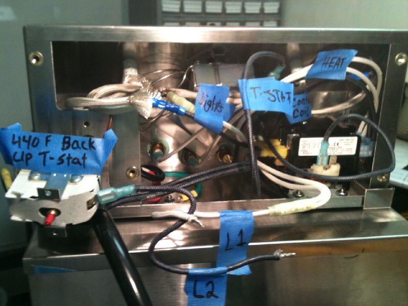

    Here is what happened. It wasn't really a stove but a deep fat fryer that the chef ordered. I hard wired it from the breaker with the one leg of 220V and the N. I filled the fryer with water for a test run. The fryer came on and heated the water to temp and quite quickly. Then when the thermostat was satisfied and went to open the contactor to turn off the heat, that would trip the breaker. I then tried switching the one hot leg of 220V to the other side of the L1L2 to see if that would make a difference but it did the same thing. There was a transformer inside for the contactor and I think that was the issue tripping the breaker. It certainly heated the elements just fine.

    Can you post the make and model of that unit so we can look at the circuit diagram?
    Most appliances have a diagram pasted to an access panel so you might have it available anyway.

  17. K1W1
    7,443
    The parts list for that machine doesn't show anything in way of a transformer.
    If the timer is mechanical and the thermostat is only used to control the contactor coil you should be able to use that no sweat on 240/ 50.
    What is the rating of the breaker you are using to supply it and what is the style of breaker?

    K1 You hit the nail on the head. As I was taking this wiring picture I saw that it was a 6000 Watt fryer. 6000 / 240 = 25 Amps. The breaker used was a 10 Amp that fed a salamander. It lasted just long enough to heat up the water causing me to think the T Stat was satisfied before popping..
