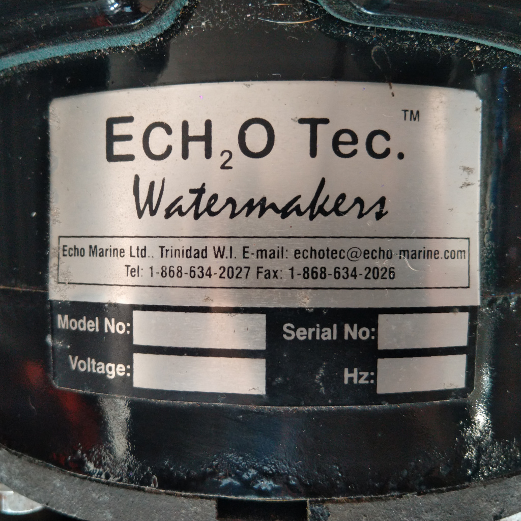

    I'm currently in the middle of a pretty significant refit and just pulled the old watermaker out of the lazarette. It's an EchoTec unit (hence the title), control panel looks pretty poor, pressure vessels bit rusty but hopefully ok, and pump/motor assembly look decent albeit flaking paint and some surface rust.
    Nameplates on pump and motor have been removed with ET putting their own branded labels on. There is literally no useful info on them (see attached pic). After further digging I believe the model is 690-AML-2. This was scrawled on some loose ET documents.
    I contacted ET with all the info I had, asking for confirmation of model and basic specs like power supply voltage and frequency. I got a very short answer saying they wanted to sell me a new motor and panel breaker. I replied requesting specs again so I could source my own equipment, possibly even boosting output somewhat.
    The brief reply simply told me they don't disclose the "engineering details of our systems, as this directly contributed to the proliferation of ECHOTec imitators on the market today." He also mentioned any increase would require both pump and motor replacement.
    I replied again stating I can provide my own motor and assured him I wouldn't be running out making chinese knock-offs of their gear. Not that they even manufacture anything o_O
    He then replied with a treatise about how their systems are a result of 25 years of r&d, millions of hours of real-world testing, other companies using information obtained from them, yawn... comparing my question to requesting proprietary engine design from a car manufacturer.
    My response reminded him we were talking about small-scale RO watermakers, the principles of which are well established and understood. Especially when you're using COTS equipment, i.e. non-proprietary commodity parts. Not sure where he thought the IP was...
    Anyway, that route seems to be a dead end. So my question remains as per the title: does anyone know anything about these systems so I can put together something I can actually use and know what I've got onboard for spares, repairs, etc?

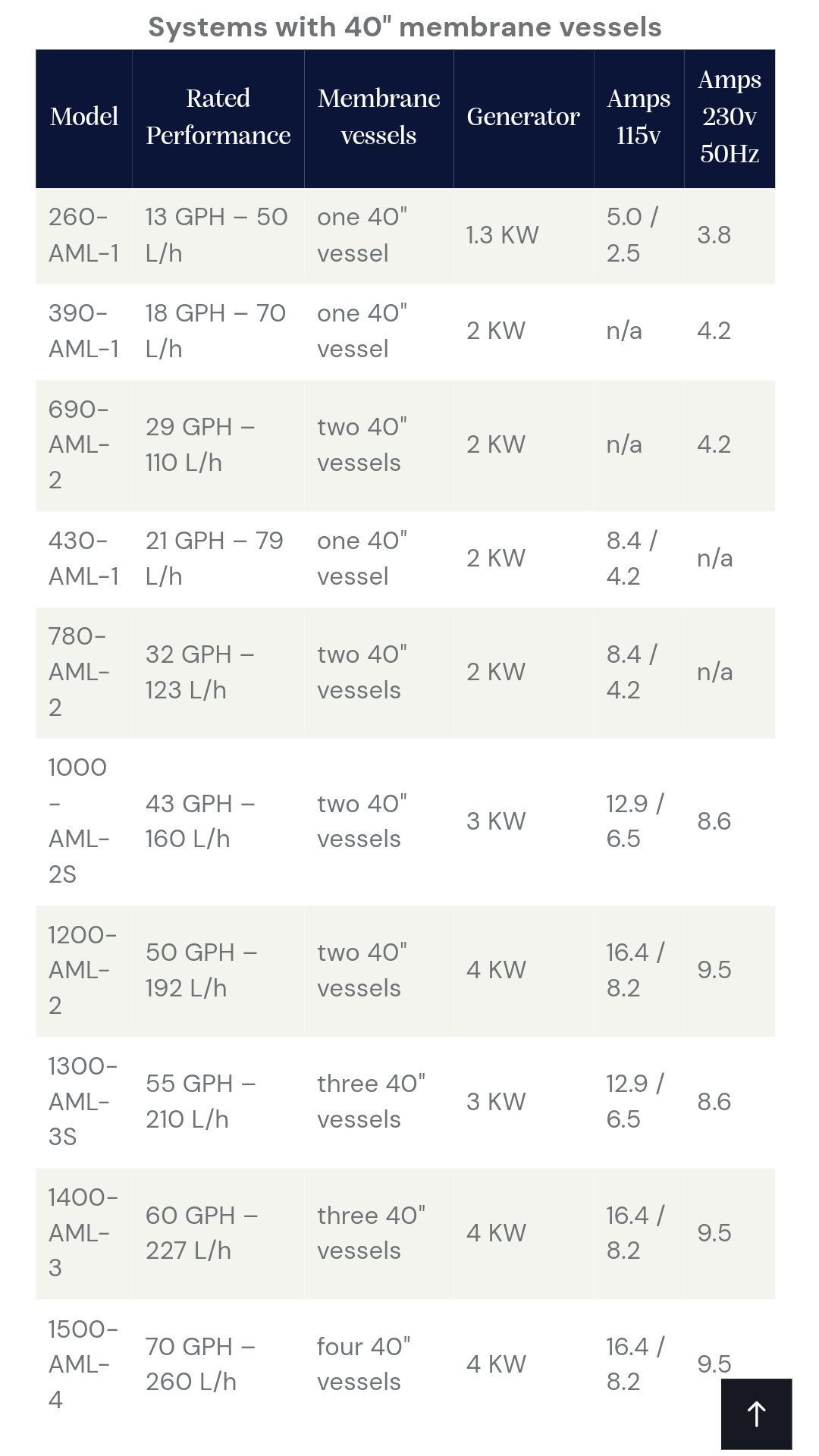

    Looks like ET disagrees with you. Notice how current draw and power required increases with increasing output? ;)

    In case anyone might be interested, here is some info re: pumps and motors used in these ET systems.
    Pumps are Speck NP10 series triplex plunger type rated at 1420rpm, likely the NP10/4-150 in the 690 shown above. This pump is probably used in the five systems 260 thru 780. It's not clear if they're using two or three pumps to cover the full range, the 1200, 1400 & 1500 are likely using the Speck NP10/7-150 but can't say for certain.
    Motors are more straightforward, Leeson capacitor-start TEFC 56C general purpose type. Rated power starts at 1hp for systems 390 thru 780. This motor must be spec'd 50Hz or 60Hz. For 1000 & 1300, rating is 1.5hp, can be wired 120/240Vac 50/60Hz as desired. 1200, 1400 & 1500 rated power is 2hp, again 120/240Vac 50/60Hz.
