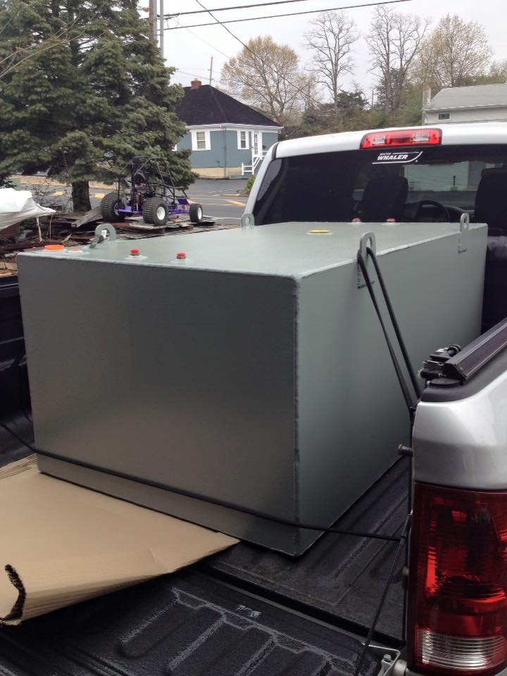

    Atlantic Coastal Welding built my replacement for my aft tank. I beg to differ Captain J, aluminum will be quite long lived if properly installed and yes, kept dry.
