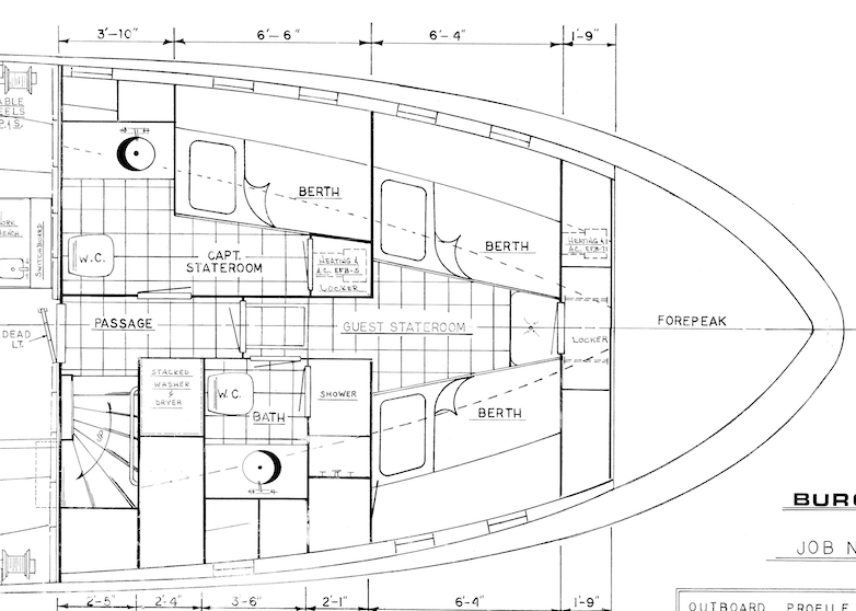

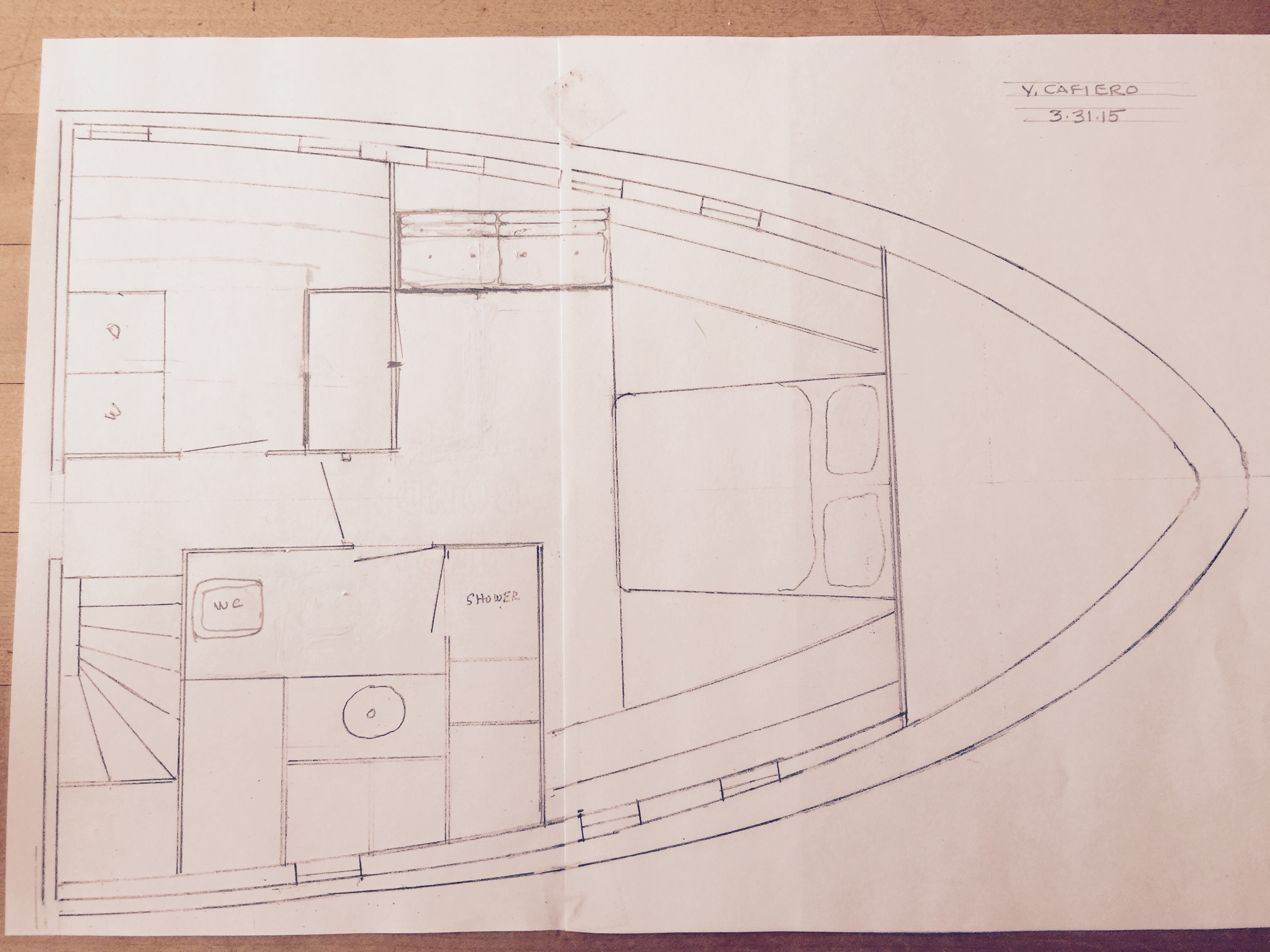

    Forward I had a captain stateroom and a crew v berth. I reconfigured and built a VIP queen in the space of the former V berth, shrunk the captain down to the length of its berth, shifted that space into the VIP, and resulted in the outcome that you are considering. It's a pretty easy project on many boats with that type of forward layout. If you're considering the used market, don't be afraid to consider the modification approach to an otherwise terrific vessel.

    Before and After Plans for Fwd VIP Conversion, Just for as an example. In the end I spun the head outboard and cleared space for a second entry to the bathroom for the captain. Screen Shot 2020-10-14 at WednesdayOct 14, 20203.14.52 PM.png VIP Suite.jpeg

    In truth it's a very easy project that doesn't require structural compromise or a big budget in many cases. I made the changes for many of the same reasons you're contemplating.

    RTrafford...that looks like a great reconfiguration. Roomy for co-captain and spouse...what size boat do you have.... I find the difficult part is looking at floor plans and trying to see what a reconfiguration would look like....so much easier to do it when on the boat..but that is a lot more time consuming and I am not looking to waste someones time.

    She's a 68. Master and two guests aft, and a VIP plus a captain forward. The reconfiguration is somewhat easy to see on paper, to envision what can be done, but then the idea has to be vetted aboard to study structural impacts, plumbing, hvac modifications, etc. Mine really turned out beautifully. That VIP is a terrific cabin and the centerline queen provides a lot of storage as well.
