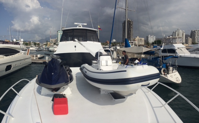

    Does anyone have any experience on installing an additional cradle on the foredeck of a Sportfish? I bought a 13 foot AB inflatable for my 66 Ocean, but I would love to also be able to carry my jet ski with me. I´ve seen a few boats on the internet with capacity for 2 jet skis, but I´m not sure if my boat can handle the weight on deck of the dinghy plus the jet ski. Should I stay away from the idea and just tow my jet ski around?

    You can't tow a jet ski around, fast anyways, at cruise the water running into the intake grate of the jet will actually flood the jet ski engine. It's possible to put both up there, and the fore-deck probably can support it with proper placement. Having that much weight up there will definately negatively impact ride though......and is it really worth doing? You'd be better off towing a boat behind you, and putting the waverunner on the bow.
    I'd much rather tow a 25' center console behind the sportfish (or larger), and putting the waverunner on the bow. Then you have a very useful tender for just about anything.......fishing, quick dive-trip while the house stays at the dock, beaches, towables, etc......

    Something else you need to consider is if you put a second toy on your bow, you need to make sure your davit will reach and adequately pick up the weight. if you have to purchase a specialized davit, it will most likely change your mind about putting anything else on the bow... as they are extremely expensive.

    O think I might just tow the dinghy and carry the jet ski onboard. The dingy has an aluminum hull and good tow hooks. You're right about the davit, that's something I think will make it impossible to have 2 toys up there.

    both the Jet-ski and dinghy wiegh a total of 1300 pounds. That's equivalente to 8 people standing on the foredeck. Would that affect the stability much?

    I would not think that 1300# would effect a 66' boat. In my case, our Sea Doo is approx.. 1,050# with fuel, and our 14' dinghy is virtually the same with fuel. So combined I was looking at potentially 2100#
    As I mentioned prior, the other reason we did not consider it was due to the davit. I would have upgrade from our current one to handle the different positions, but it was also questionable if the current one was located in the right place on the deck to start with.
    One other concern I have that you may not is the construction of the deck. Ocean is not known for over building anything, and am concerned our 63' may not structurally handle the weight in rough seas. That is a lot of weight on the feet of the chocks, concentrated in small area.

    seems to have worked OK so far.
