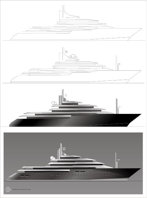

    I think I am the only one designing in 2D, from the first line. Many designers are still using pen and paper and later has it done as 3D renderings in the computer.
    We have seen some guys here, like Ricardo, using high end 3D-programs like Catia also for the conceptual drawings.

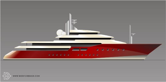

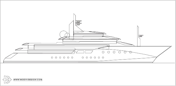

    My program is called Freehand (not expensive) and there are many similar programs using vectorized postscript. Here you can see how this yacht was drawn up as simple lines to frame the colored fields.
    This took me less than two hours to achieve.

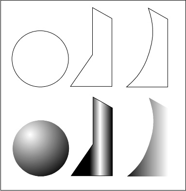

    It is basically very simple. You have certain tools, like making a circle, or freehand drawings where you plot the shape. You can then mark a point and choose it to be curved as you can see how my second shape became the third.
    You can then select thickness and colour of the lines, or remove them after you have filled the shapes with gradient, solid or patterns in the colour you like or a blend of colours.
    By putting different shapes on top of each other you build your yacht or whatever... ;)

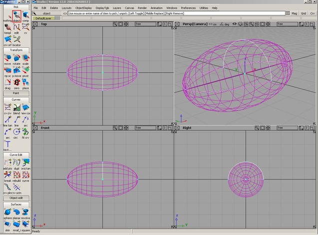

    Well, at University, we started off using 2D AutoCAD, which is a very precise tool. Then when we had got to grips with that we moved to a program called ALias Studiotools. This is a very powerful program and can generate some amazing quality images.
    Basically, 3D designing is very much like working on 3 2D drawings at the same time. The image below is a screen shot of Alias, you have your 3 2D views top left and bottom left and right and the perspective 3D view in the top right.
    You can work in each window individually, so you can do your 2D side view, and your top and front views and then move the lines out and up so it then creates a 3 dimensional model. Then you add surface generation curves and then your surfaces and then it starts to get complicated! But it is a very good skill to have. If you can picture your design in 3D in your head, then you should be able to grasp it in a 3D program fairly easily.
    In the image below i have drawn an oval in the top view (top left) and then a semis circle arch, attached to the middle of the oval, in the right hand view (bottom right) then a mono-rail surface was applied and in the the 3D view (top right) you can see the shape in 3D made from two simple curves. Easy. ;)

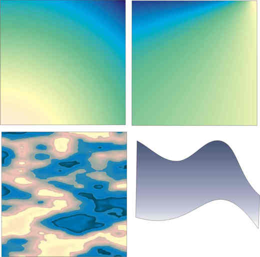

    Nope. Trying to drop in an additional color just changed the prior color. Turns out that Corel Draw can do multi-color fills. But you get to pick only the "end" colors. The intermediate colors are then taken from the color wheel. Here are some fill examples from Corel Draw:
    Upper left corner: Radius fill using multi "intermediate" colors with center offset below.
    Upper right corner: Conical fill (wedge) using multi colors and offset.
    Lower left: Texture fill with multiple color picks. This is actually very rare, most texture fills that are provided allow only 2 colors.
    Lower right: Freeform shape with linear fill. Note that fill is still "straight", does not try to conform to curved shape of the edges.
  17. AMG
    5,378
    Good finding then!

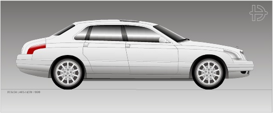

    I can not make the wedge shape, but have a blend tool where I can take a few gradient pieces, also in colors if the pieces contains the same colors. I once made a headlamp of a car this way, just in black&white.
