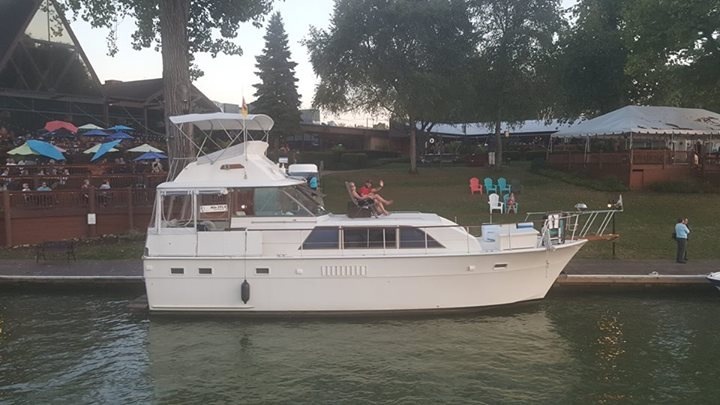

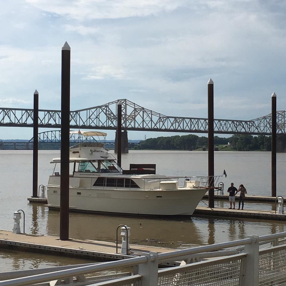

    Well Jeremy, what do you want to know! Looks like you and I are not far off from each other's situation. I am 37, part- time live aboard with my pup Brooklyn Hatteras Kidd "Hattie." I have a 1975 43 Double Cabin that I have put a lot of sweat equity into. (I can address the girlfriend later).
    Here is my take on what your looking for and you can hit me up for any other details.
    Overall you can't go wrong with a Hatteras. My boat still turns heads. I will dock next to a new SeaRay and 9 times out of 10 I have a group of people wanting to take a tour of my boat.
    The key is to find a solid boat with good bones. I am the third owner and have had Kidd'nAround for 3 years. I had the same idea as you and that was to find a solid boat that just needed some cosmetic updates. Even though I found exactly that, there was a surprise in the nickel and dime items that I didn't expect. I would consider myself very handy and I have completed most of the work myself. I have learned where to sub out for help.
    I had a marine survey completed, but I found out that they missed quite of few things. Even with the best survey you will need to prepare for things just breaking. As soon as you finish one project, you turn around and it's something else breaking. For me, I enjoy the challenge if fixing it and this is typically how I plan my next project. It gives me a chance to upgrade it or replace it to new. If your looking to buy a boat, update a few things and relax with a beer then you might want to reconsider being a live aboard. You will always have a half page to-do list. Don't get me wrong I have my fair share of fun and use.
    My only engine experience is with the Detroit 671 diesels. My engines have about 1700 hours and have not given me any issues. I had to replace the fuel line hoses due to old age. Some general maintenance, but they are exactly what everyone says, bullet proof. I think everyone would agree that whatever you decide, get diesel. Gasoline engines just don't compare.
    With most boats this age you will spend a lot of time updating plumbing. Hoses, pipes etc just tend to rust or give out over time. I have replaced most of my old copper lines with PEX. It gives me an opportunity to minimally winterize in the winter.
    Another area I have spent a deal of cash was with electrical. If you are choosing a boat around the same age as my boat then the technology of the day didn't didn't have a good reputation of DC power. I was having to run my generator at all times just to have lights and run the refrigerator on short trips View attachment 76332 . Be prepared to add a few inverters. I have converted all of my lights to LED.
    I guess the big ticket items that I didn't expect was things like having my props reworked. It was $500 each prop. Having the boat pulled for any work done is $240 out and $240 back in. Not including if you need to be in the yard for any amount of time. Living in the Midwest these numbers might vary from you.
    As for the girl and the house.... My girl gave it one season and then was out. "Me or the boat," I wish her luck!
    Not sure your situation, but I started listing my house on AirBnB. It gives me the opportunity to keep my house and some cash to help pay for the boat. Just a thought!
    Good luck with your search and let me know if you have anymore questions!
    Dustin

  19. chesapeake46
    chesapeake46 Senior Member
    Jul 26, 2009
    1,781
    Dustin,
    Good story, Nice looking boat, great hot tube.
  20. KiddnAround
    KiddnAround New Member
    Oct 13, 2016
    Louisville Ky
    Thanks! The pool is a great addition on a hot day.
