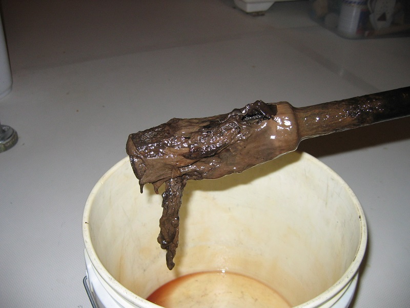

  7. Capt Ralph
    12,649
    Finally found some old pictures.
    Here is what adding snake oil to my aft diesel tank did.
    That is the screened end of the mains fuel pick up tube.
  8. Boomer
    Boomer Senior Member
    Oct 14, 2017
    677
    Seminole
    OMG...point made sir!

  10. Capt Ralph
    12,649
    Thank you. And yet folks still endorse their fav snake oils.
    Oh, this pic was after a big name brand snake oil.
    So, repeat after me, Don't fix any thing till there is an issue. I further promise to use fresh fuel and cruise very often. Purchasing fuel from good vendors and checking filters often.
