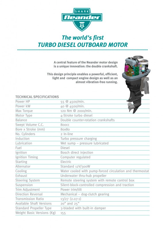

    This model may be less powerfull but much closer to production. A working example was shown at the Boot 2013 at Düsseldorf and the SMM Hamburg 2012. It will be the perfect outboard engine for SOLAS rescue boats, because it eliminates the need for petrol stores on commercial ships.
    Willkommen - Neander Motors

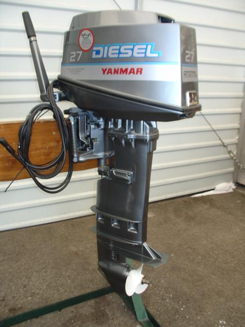

    Diesel outboard
    There used to be a Yanmar D 27 and a Yanmar D 36 diesel outboard engine on the market. It was mostly used by public services (Navy) or for commercial applications like workboats and small fishing boats. Due to its running characteristics and weight, it never made its way into pleasure boating. To my knowledge, it is out of production but still available on the second hand market.
  6. Capt Ralph
    12,725
    I almost bought one of these years ago on the used market. It was very popular on the international market but parts/service was really not common in the North America (NA) area.
    Shame.

  8. HTMO9
    HTMO9 Senior Member
    Jan 13, 2009
    1,670
    The Yanmar Diesel Outboard was very reliable and very low on fuel consumption. But heavy and not easy to operate. The engine had to be bolted through the stern (no easy removal) and when tilted it could not be locked in the up position. Plus its vibrations could tear the stern of your boat apart. But for government or commercial application it was liked very much.

  9. K1W1
    7,392
    At 155kg fora 55 HP outboard I would relax on the self stimulation waiting for worldwide adoption for Rescue Boats.
  10. HTMO9
    HTMO9 Senior Member
    Jan 13, 2009
    1,670
    As far as yachts are concerned You are probably correct. For mercant ships its still on the heavy side but acceptable. This is the weight of the prototype engine. Lets hope it loses some kilos til production starts. Otherwise it will be another development for the museum.
