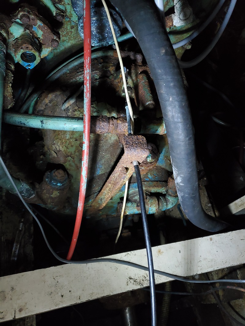

    I'm not mechanically inclined at all and I was told by someone that knows my boat that he believes someone hit the emergency stop upstairs but never reset it on the engine. My Google-fu is failing me please send pic's

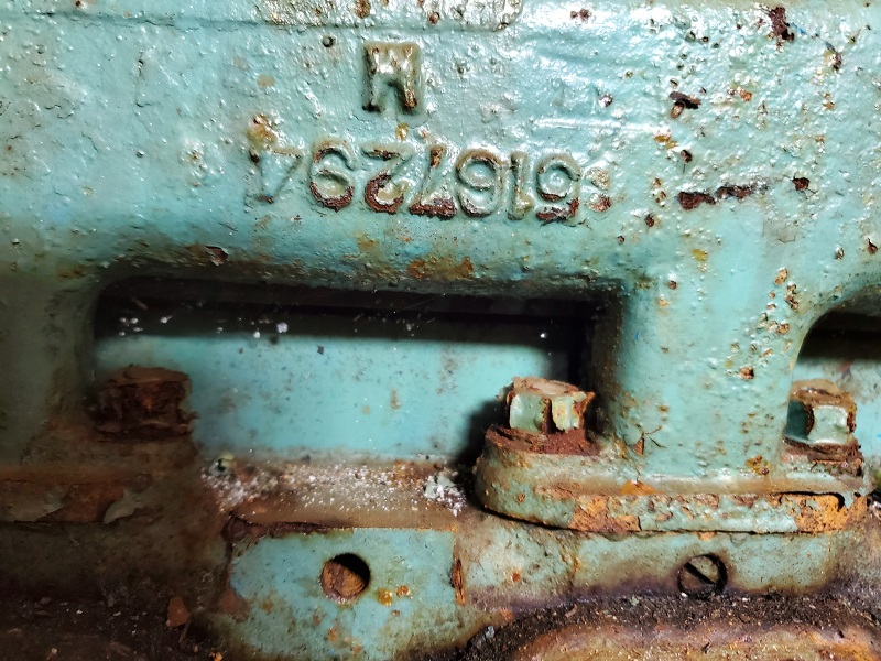

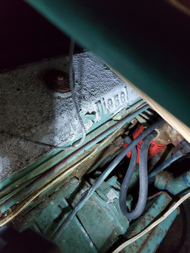

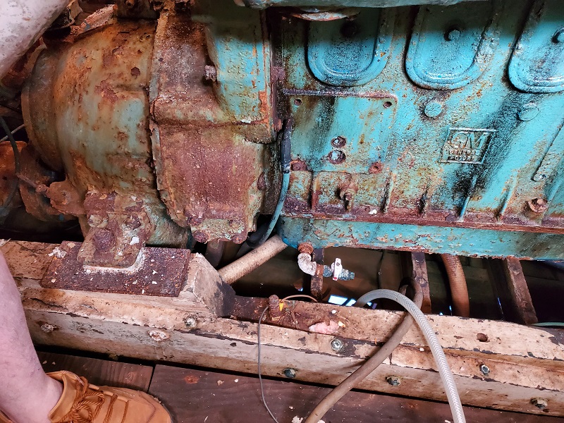

    My photos seem to be to big but I found "Detroit Diesel", "GM" and "5167294" and those numbers have an "M" under it
  6. Milka
    Milka New Member
    Aug 1, 2019
    21
    USA
  7. Milka
    Milka New Member
    Aug 1, 2019
    21
    USA

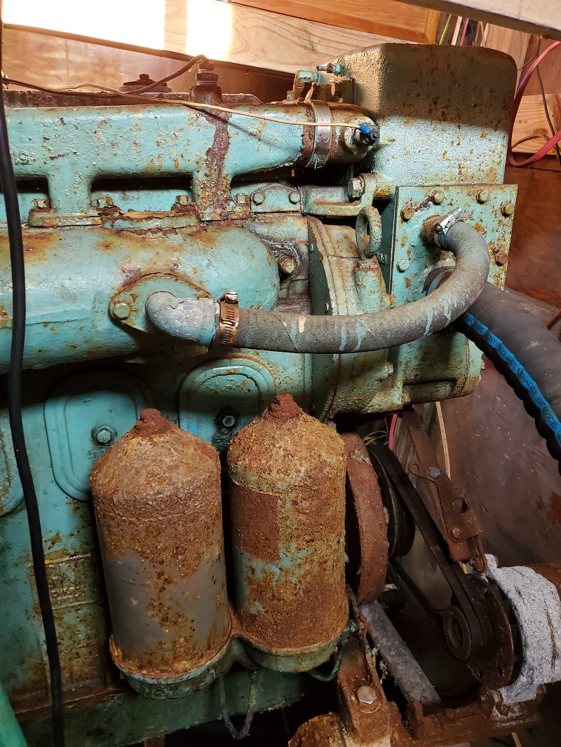

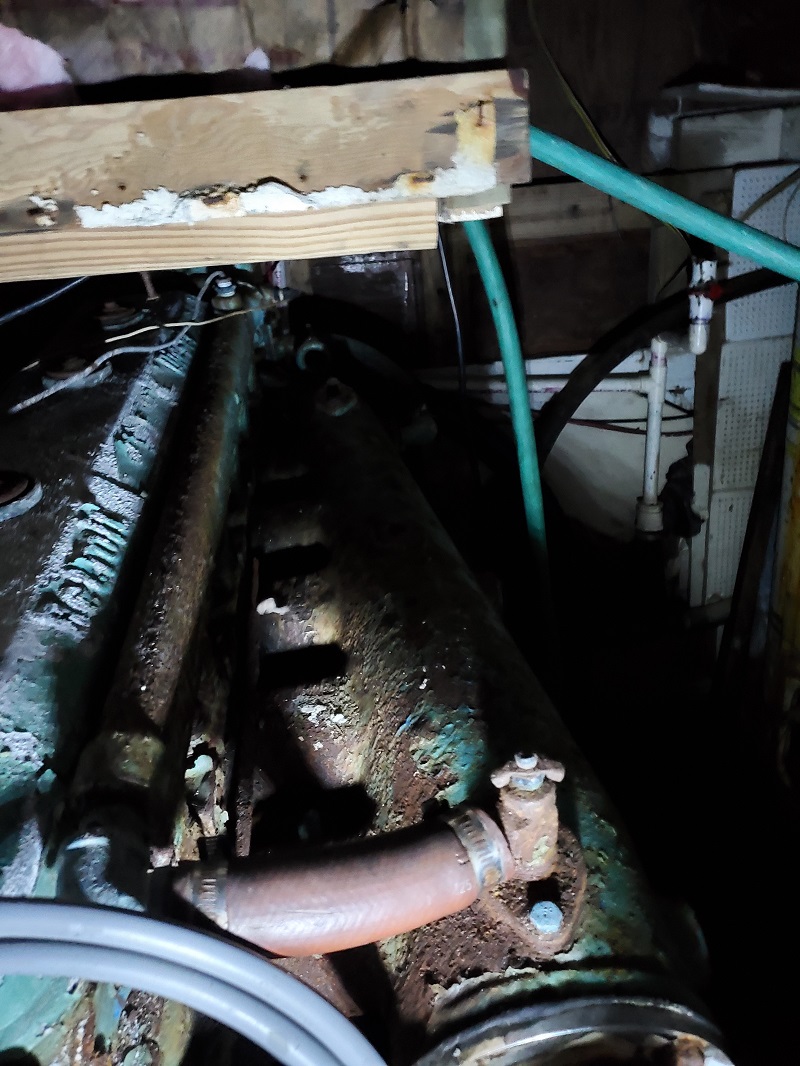

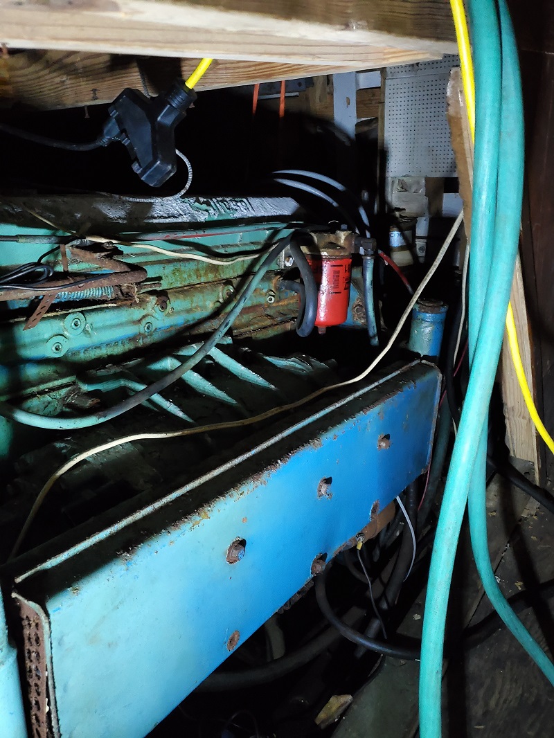

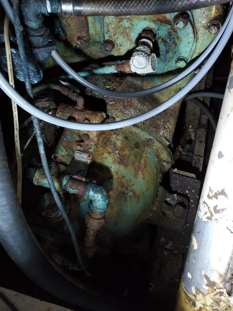

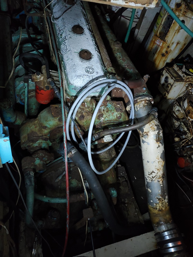

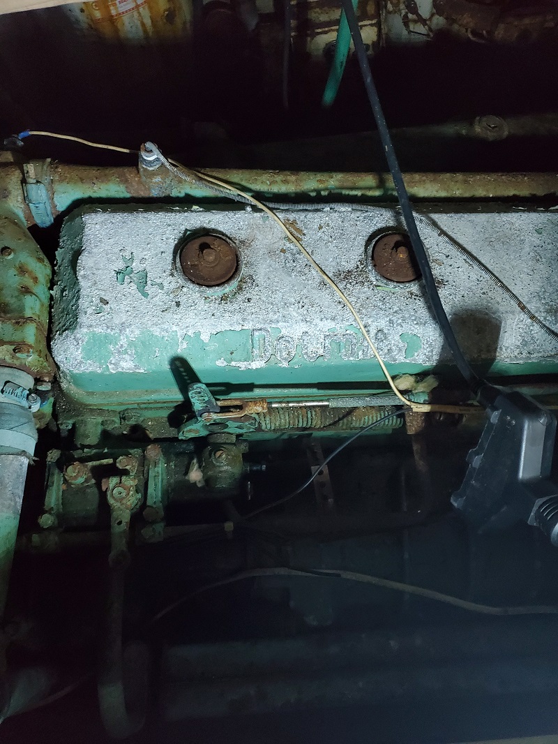

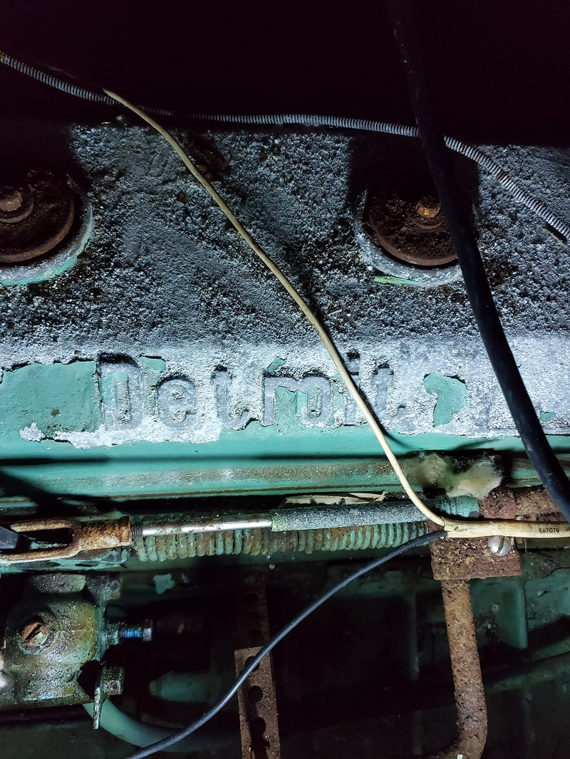

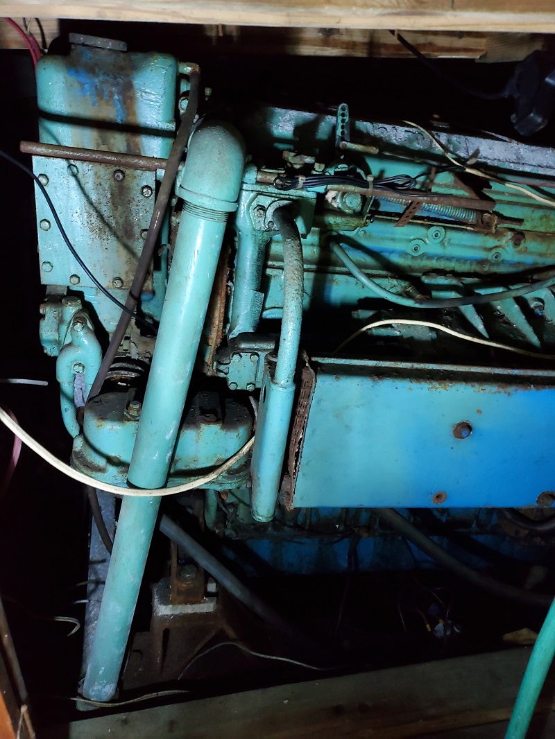

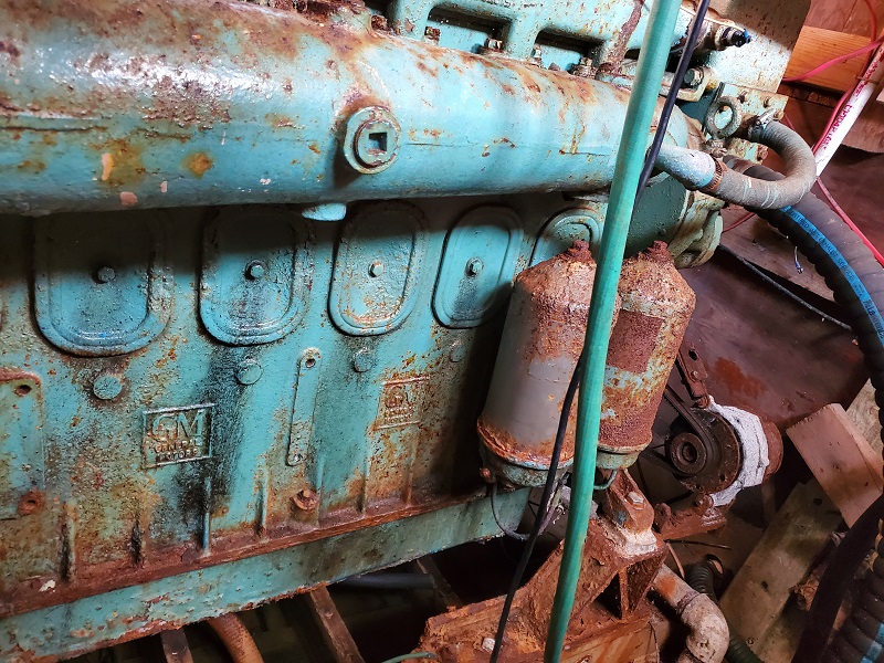

    Sent photos to a mechanic and he said its a
    6-71 N 230hp
  8. Capt Ralph
    14,523
    I looked over pictures sent.
    It is an original 6-71 without blower shut down flapper.
    I'll resize the pictures and post below in a few minutes.
    Any long set of numbers that start with 51 is a later part number.
    5167294 is the water manifold part number.
    That is the later head, water manifold, valve cover and exhaust manifold.
    I can not tell if that is the 2 or 4 valve head.
    Further, I do not see any shut down system attached to the governor top either.
    Original GM/Allison M clutch.
    Sweet ole girl needs a new dress.
    I'd say most of that rust is from condensation. When was the last time she ran and under load?
    Keel cooled? Raw water pump just goes to a later exhaust dump can.
    With the un-original idle set screw, I would say throttle all back kills the engine.
    Open the throttle some and try to start her.

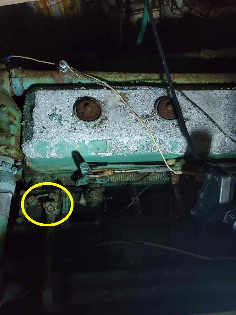

  17. rtrafford
    rtrafford Senior Member
    Jul 13, 2019
    1,979
    Vero Beach

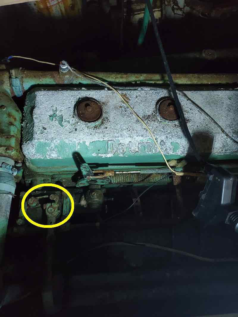

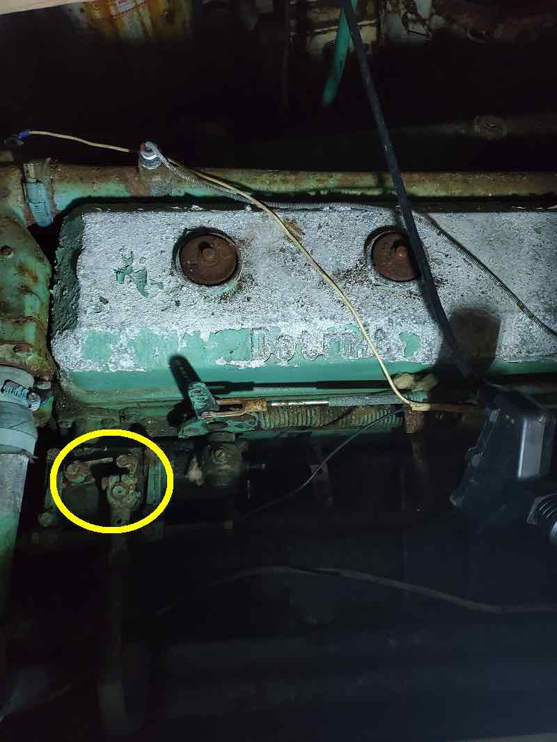

    Ralph,
    not familiar enough with this series, but what's this right here? Appears to resemble a cog?
  18. Capt Fred
    Capt Fred Senior Member
    Jun 22, 2009
    319
    Long Beach CA
    upload_2020-5-9_7-5-1.png Observe the starter motor duty cycle.
  19. Capt Ralph
    14,523
    Yep, That is the governor kill lever, Nothing attached to it. When pulled on, it over rides the governor and pulls the racks to no-fuel and the engine dies.
    It also has a nice spring action to return to the run position.
  20. rtrafford
    Jul 13, 2019
    1,979
    Vero Beach
    Right, but doesn't it appear to be disengaged/killed? Doesn't appear locked and loaded....
