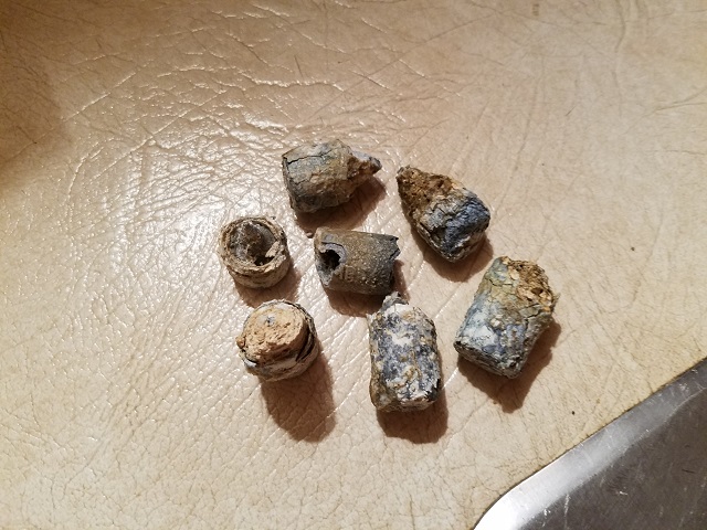

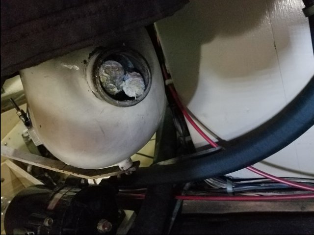

    I'm a bit embarrassed to post this. But hopefully it can help someone else. My port engine has been running a bit high at cruise for quite awhile. Despite cleaning the heat exchangers, it would get worse as the sea water warmed up. I know from boatdiesel about checking the exhaust shower head. (This behavior is typically a lack of water flow). Which I did by removing the exhaust hose and inspecting the spray holes. Checked from intake strainer through each piece to the exhaust over the years (except one!!).
    I finally decided to take the hose off that is attached to the exhaust. Very happy to see it blocked. I couldn't believe any water was getting through. 7 pieces in the port, 4 in starboard (that stayed at 175 at cruise).
    If you have the large zincs 3/4x3.5" in the heat exchanger, apparently the top inch breaks off at some point. (I need to change them more than once a year). It's worth the time to check. Temps were great this weekend!!

    Unfortunately, exhaust systems are overlooked as being part of routine inspections. You headed in the right direction by going to the mixer to check for blockage. I would suggest that you look at the hose connection and for fiberglass discoloration as signs of overheating. Also, if you have black hose, I would suggest you upgrade to the blue silicon hose. This has an operating temperature of 350 degrees and is much easier to work with. You will also need to change the clamps as the wall thickness is less with the silicon hose.
