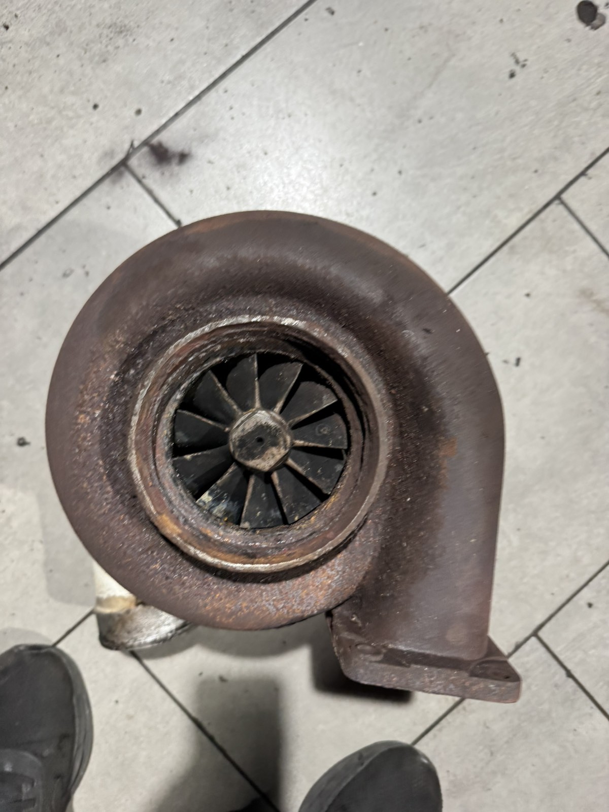

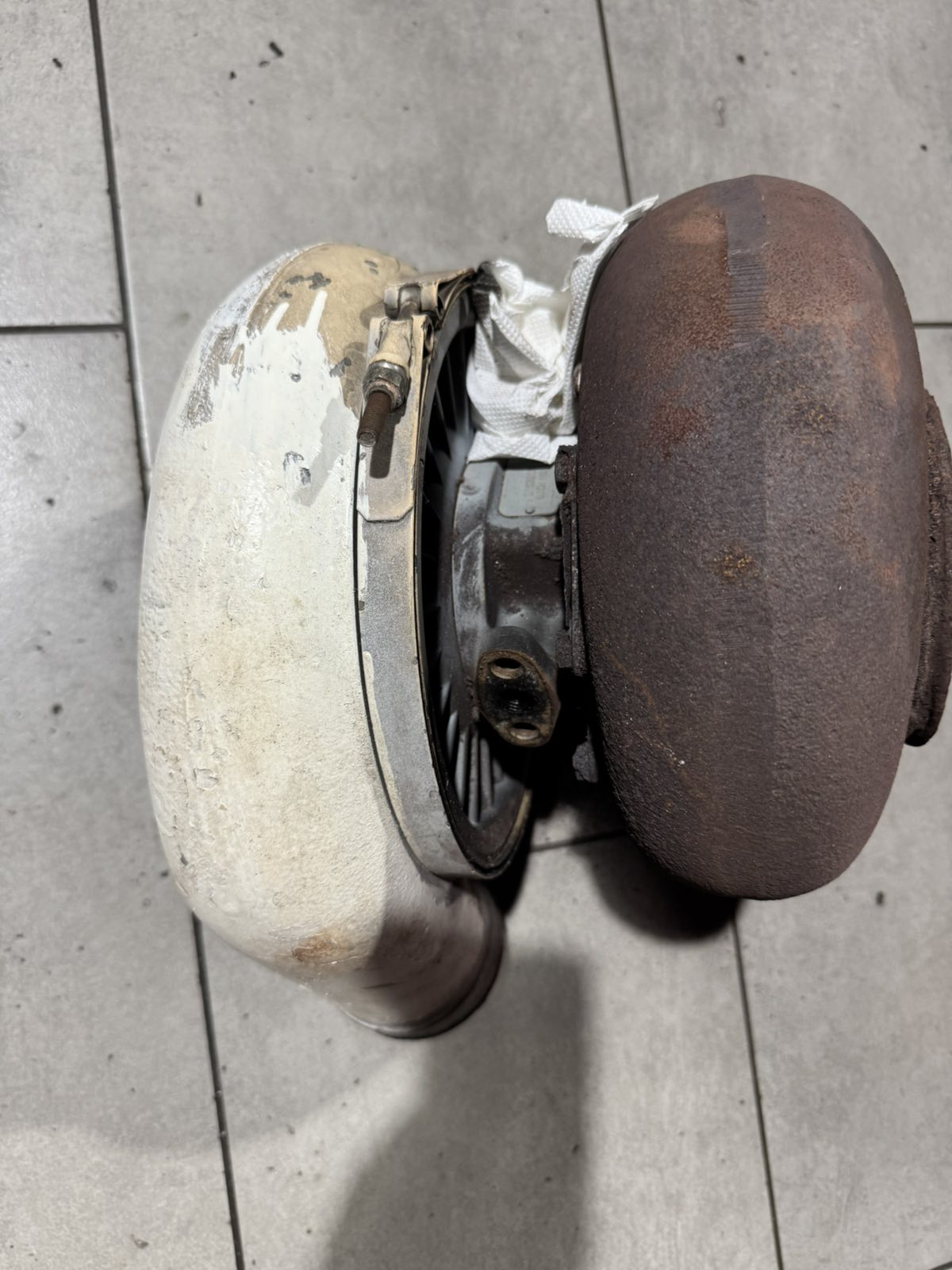

    I just bought a used Chris Craft Commander 422 with 2 Detroit Diesels 450 hp from Covington.
    I took out the turbos, and one of them is in really bad condition from the exhaust side. It is very rusty from the seawater, probably.
    My mechanic told me that it is not repairable and I wonder where I can find this part of the Turbo, either new or used.
    εικόνα_Viber_2025-08-07_20-36-07-922.jpg εικόνα_Viber_2025-08-07_20-36-08-119.jpg

    With the engine serial number, Find a local MTU/DDC shop and order one.
    There should also be a part number stamped on that tag. Maybe starts with 51****. Search the internet for that may help also.

    The Label on the Turbo shows the number 5103838.
    The engine serial numbes are : (P) 6A 456203 & (S) 6A 456213.
    I have found this, but I am not sure if it is the same.
    http://www.invasionautoproducts.com/deditrt1tu40.html
