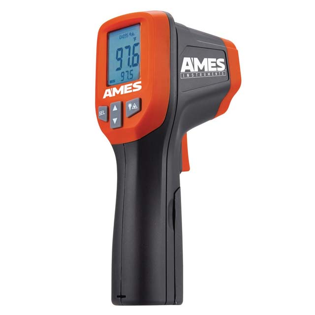

    I've been running 671s since the early 1960s. Usually when twins crank differently, it's electrical. Besides the battery and cabling, the solenoid can have contacts that are making a poor connection. There are two lugs where the battery cable and the starter motor connect. They contact a copper disk the rotates slightly each start. Eventually, long starts cause burning and pits on the lugs and disk. If you're ambitious, you can disassemble the solenoid and file ends of the lugs and disk to like new and restore the ability to transmit full amps to the start motor.
    With the engines warm and running under power, you can use a hand temperature measuring gun to read the temps at the exhaust ports and get a good idea of the cylinder conditions. One cylinder running cold could indicate a problem with the rings, valves or injector in that cylinder.
