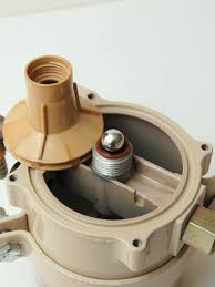

  14. cleanslate
    cleanslate Senior Member
    May 29, 2018
    1,648
    Cherry Hill, NJ
    I would first drain the Racor unit, then disassemble it clean out with fresh diesel get all the dirt and stuff with in the unit out , including the steel ball ,etc. like in the picture above. Make sure you put everthing back together as it came apart! Take a photo or two before and during the disassemble to refer to if you need. And install all new O-rings and gaskets.
    While the Racor is apart or before it's apart shut off the fuel ball valve before the filter to stop the flow of fuel. You should have a natural flow of fuel coming from your tank to the Racor . Your engine height doesn't mean a thing, fuel should be freely flowing to the Racor.
    If it's not flowing your fuel line is plugged up a little or a lot with tank skank. You may have to blow some air with a small compressor back into the tank through the fuel line from the ball valve back to the tank, to remove the blockage. One or two puffs of air through the fuel line and listen for the air bubbles in the tank to make sure you are through and clear.
    Now fuel should come out of the line freely.
    I would recommend you get the tank cleaned/fuel polished too if you find the line was plugged up.
    See if that doesn't help with your starting problems. I'm not aware of fuel every flowing back to the tanks on boats like yours and mine. When you change the Racor filter it should refill with fuel on it's own from the tank .

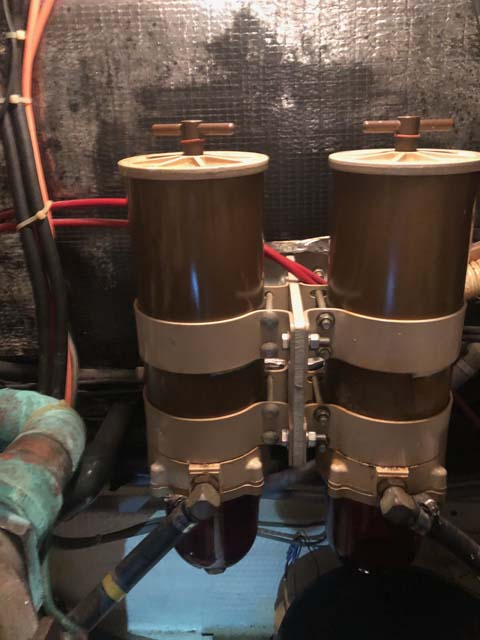

  19. Ben T
    Ben T New Member
    Dec 31, 2018
    6
    Vincennes,IN
    Here is a pictures of the filters that are on our boat
  20. captholli
    captholli Senior Member
    Jan 4, 2010
    1,164
    In The Bilge
    I'm assuming the butyl O-rings on the T handles are spares when changing elements or were they forgot when reassembly took place? If so they're now stretched beyond the threaded stud size and will be a sloppy fit.
