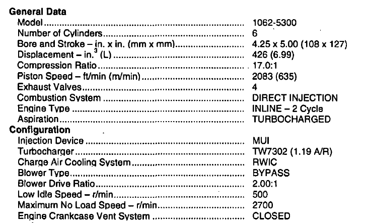

  19. PacBlue
    PacBlue Senior Member
    Jan 9, 2009
    1,995
    Dana Point, Ca
    I would be concerned with that "tall number".
    The Fuel Rack on the Governors for the 6-71 Detroit's would be set at 200rpm over rated rpm, so a No load Idle rpm would be set at a max of 2500 + 200 = 2700rpm for your engines.
    A 3062rpm at No Load would flag an issue or two:
    1. The Fuel Rack needs to be reset
    2. The Gauges may not be reading/operating correctly.
    3000+ rpm and you are testing bearings and connecting rods, if in fact the gauge was accurate :(. Sample specs for the 450hp version of the 6-71TI below:
    Ertle moore likes this.
