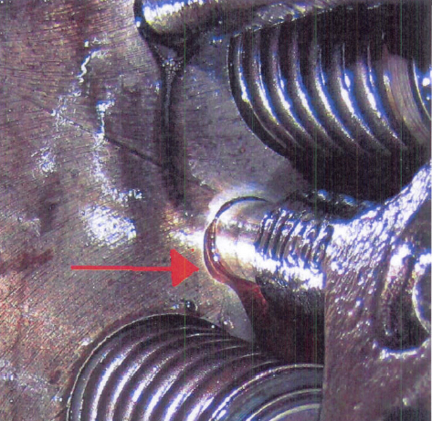

    I'm confused about the rocker bridge pin failure. Can somebody explain what happened here? I've heard of bolts backing out of one side ( never torqued)and overloading the other side and causing it to break out of the head but not pin failure on a Detroit.

    Rocker Bridge Pin Leak 12V71TI.jpg Here is a photo of the bridge pin leaking once the system was pressurized. Unfortunately, the bridge pins are press fit when the cylinder heads are manufactured and under the bridge pins is a coolant passage. Just another one of many ways to have a $50k event.

    Excellent picture and explanation.

    Sounds like somebody tried to loosen the lock nut on the adjusting screw with the bridge in place. Never a good idea! They're not designed to withstand any side load.

    If its a push fit can you not get a larger diameter pin made and push it in or get one made with a thread in the end and cut a matching one in the hole, you could even add a lock nut if you were worried about it coming loose.
  7. Capt Ralph
    13,877
    The fix is a threaded pin into the head cast.

    Bridge pin leak explanation was excellent...now i get what happened!

    So what was the final fix? New head or repaired in place?
  12. Boomer
    Boomer Senior Member
    Oct 14, 2017
    677
    Seminole
    Repaired in place...drilled out the pins and put threaded in
