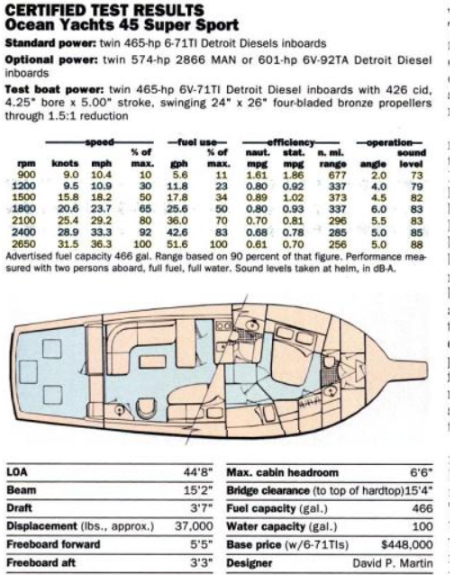

    Hi Wes. I looked hard at a few ocean 45's before going with a 43. I have attached the fuel burn chart from an old boating magazine review. I suspect the numbers in the review are a bit optimistic and that you might before a few knots slower than the speeds posted. hope this helps

    wow those are some numbers!
    plausible, considering 37,000 pounds in a 45' boat.
    I am basing it on my 46 Post with the same power weighing 48,000 pounds and a little more beam, more draft, and 650 fuel.
