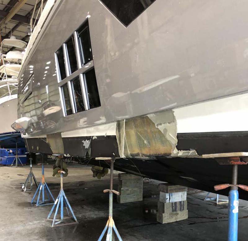

    I was looking for a 55s and i saw this listing...
    thoughts how this could happen? Azimuts are not known for this as i understand.
    price is about $125k off for the damage. its on both sides. core was weak and appears to have broken off in places where the lift straps were placed when it was hauled.

    There is no safe margin. The boat belongs on the trash heap. Someone in the business of salvaging such boats could possibly rebuild it and then make money on it, but that's a very special skillset and business niche. You, not having the experience or knowledge, don't stand a chance.

    No. You can’t just “redo the entire hull” to as new conditions at least not in an economical fashion and without adding weight. Then ask yourself: if they messed up that part of the hull, where else did they cut corners? Engine beds? Stringers? Bulkheads?
    And... the resale value of the boat will Be affected. Not worth it
    now, in all fairness it is possible that the yard messed up and put the slings in the wrong place. But still the value of the boat is greatly affected.

    Sadly, the only value in that hulk is the scrap value and not much in that.
    By the time the engines and any thing of value is removed, the cost to remove it, CYA insurance (liabilities of damages & pollution) the cost of transporting and disposing of the remaining waist,
    There is not much money left.
    Smile and run aweigh. :rolleyes::rolleyes:
    It would be cheaper, safer, quicker, still have value and you would sleep better; if you went and purchased any other boat.

    I disagree, because even the worst imaginable slings placement could never justify/explain that disaster.
    There's another possibility though, and it's that the crane (or travel lift, whatever) suffered a sudden freefall, after which it recovered the hold, causing a massive dynamic load (due to the boat weight combined with the fall acceleration) on those points of the hull.
    Sometimes, when this happens, the boat falls free down to earth, but if that would be the case also the keel and pods would be heavily damaged.
    The type of accident I'm envisaging is different, actually very rare AFAIK, and I never witnessed one.
    But I heard that there was an old travel lift model which was notorious for these random defects.
    Anyhow, whatever the real story is, pretending that the normal boat value can be restored with $125k worth of patches is beyond a joke.
    PS: not that it matters now, with the boat in those conditions, but also the way the chocks are arranged and placed cries out for justice.
    What sort of Mickey Mouse yard is that?

    The yard knows it is a total and not using all resources for proper blocking.
    In the mean time, storing inside for max storage billing.
    BTW, water still draining from fractures.

    Whenever we haul hour the yards always ask for the builders plans and usually have diver making sure the slings are in the right spot. Serious business

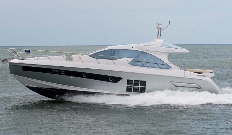

    Here's a side shot of the 55 Sport. Based on the delam pic above, looks like CG would be center of the Rubik's cube windows. To me, it looks like the slings were properly placed.
    The frustrating part about this is the level of education available to boat builders from the composite manufactures. It comes down to shoddy workmanship.

    Do you even know who owns the boat now. Previous owner or insurer or yard? And who has liens on the boat. In a strange irony I can see the yard damaging it, an insurer paying for it and now the yard having a sizable lien on it. Who knows?
