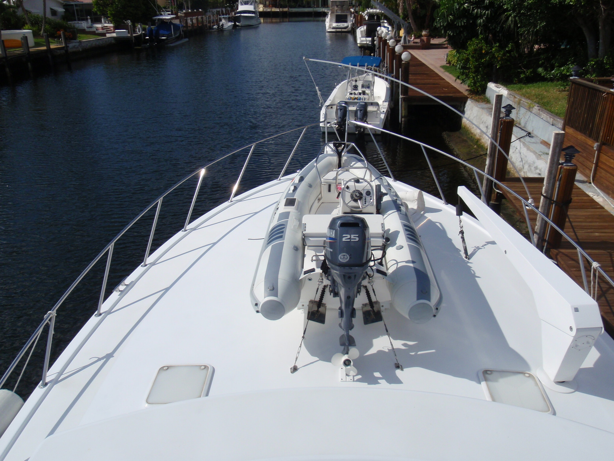

    Beau, that is where mine is mounted. The mounting post runs through the left side of the master closet into a base. I bought the boat that way so can't comment on the material of the base construction. I've attached a pic where mine is located on the deck. The davit is a MarQuipt 1500 as well. Not sure if that helps...

    Beau - I cannot tell the difference with the dinghy on/off the bow. The picture I showed previously had a 11ft Novurania with a 25hp Yamaha, since then I've upgraded to a 13ft AB with a 60HP Yamaha. I frankly can't tell the difference.

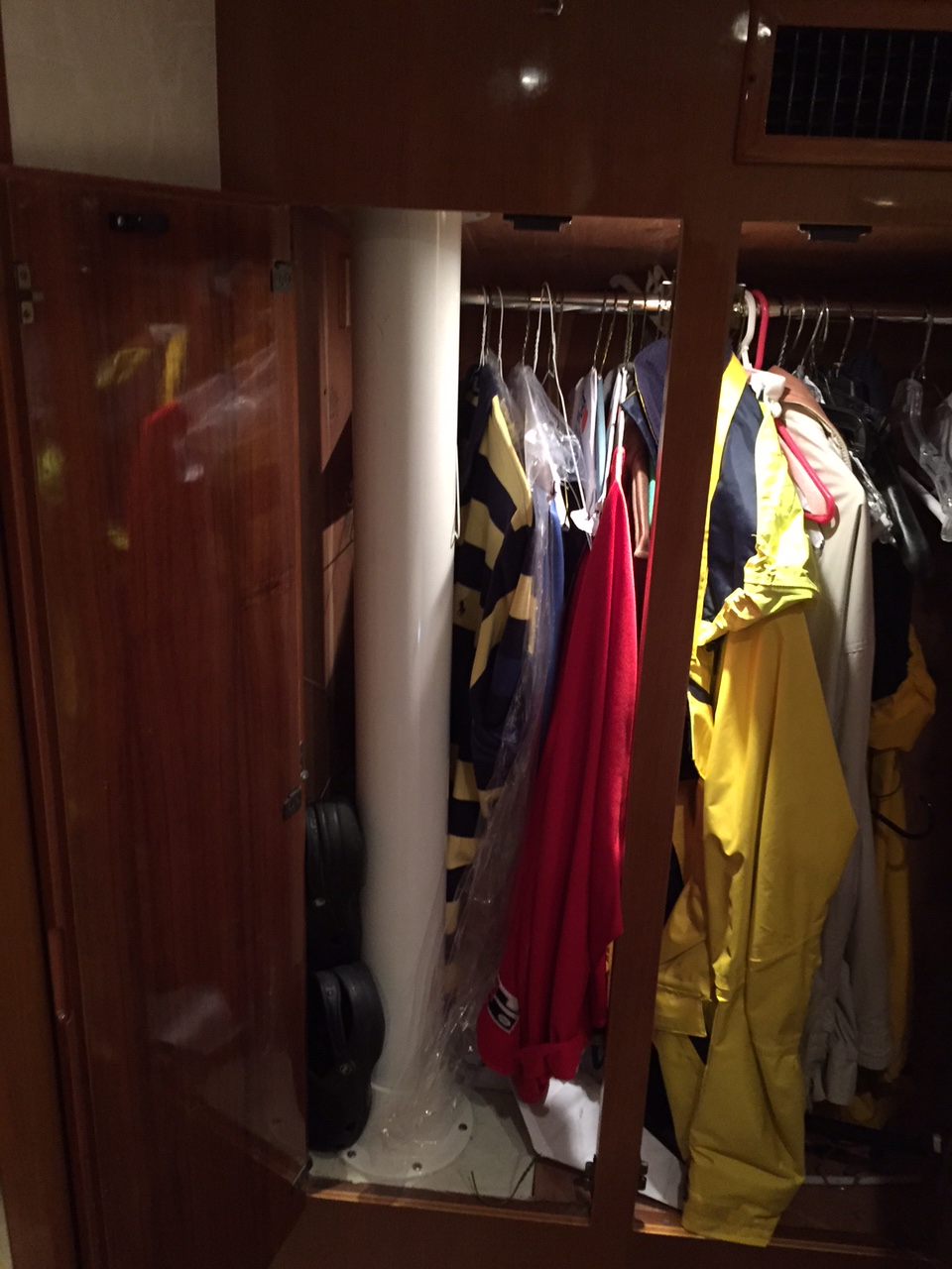

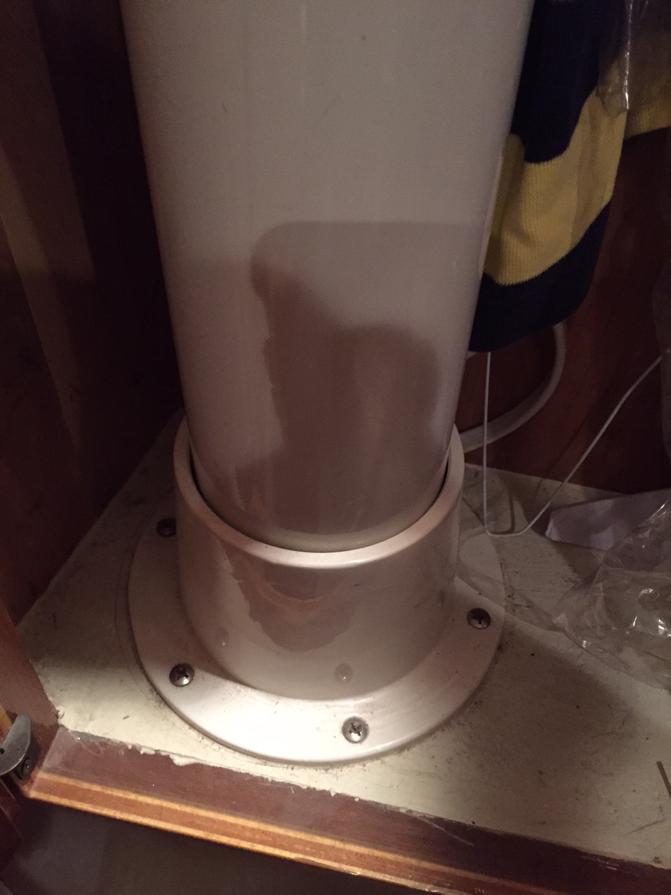

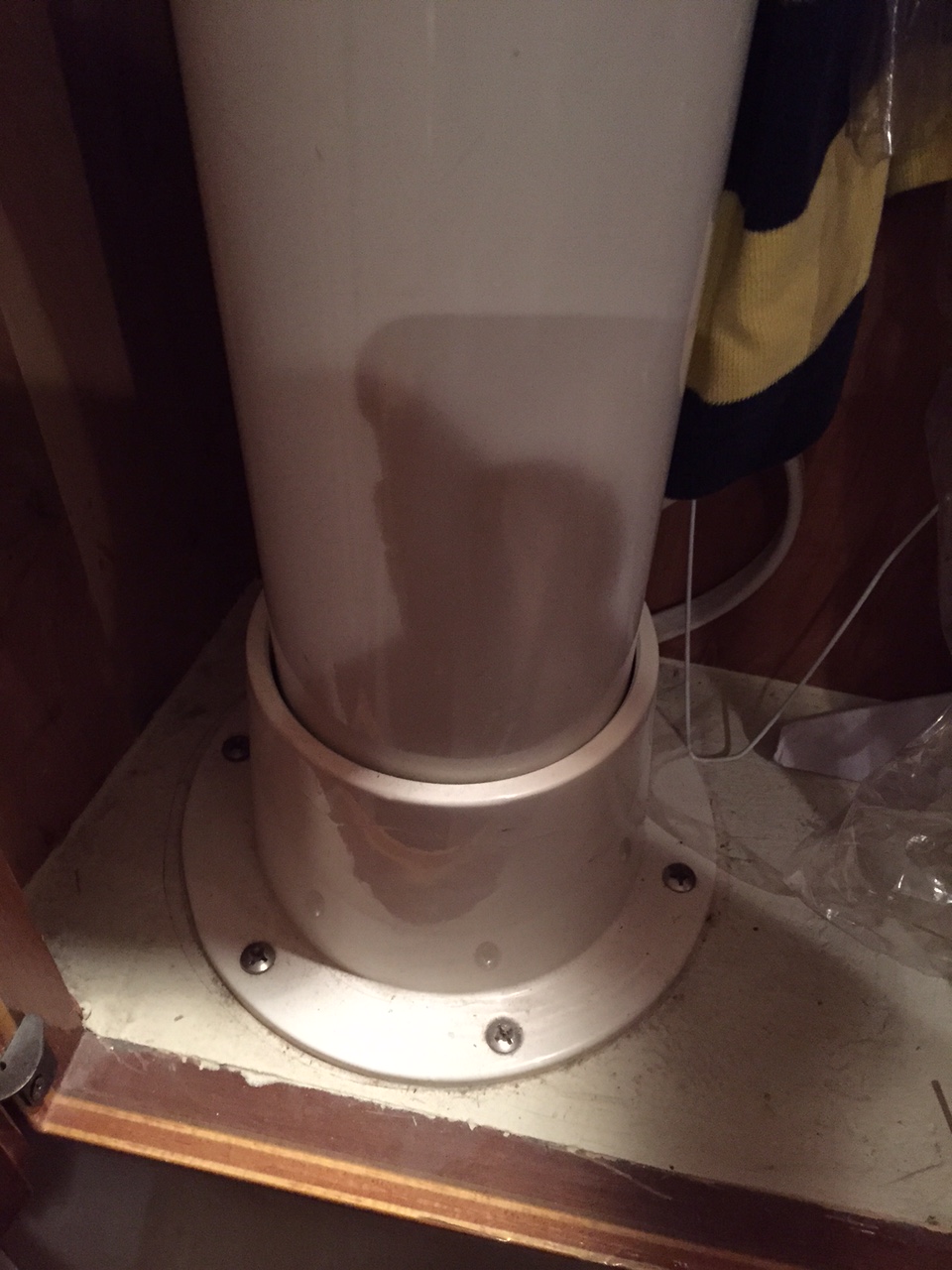

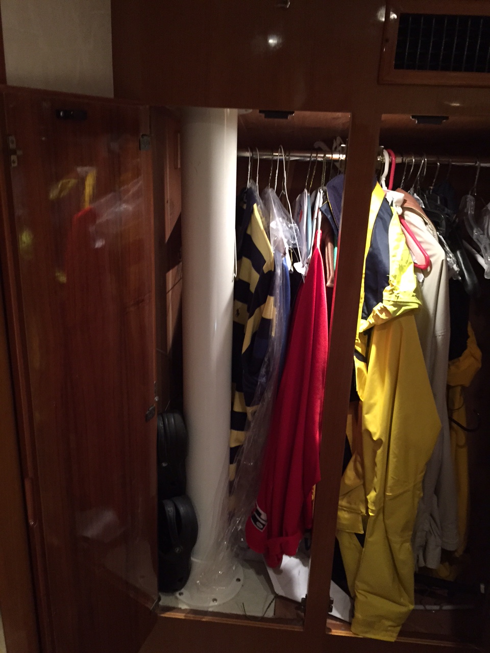

    Beau, I was at the boat the other day and remembered to take a couple of pics where the davit support is mounted. Here you go: IMG_2284.JPG IMG_2282.JPG

    Beaufort, NC
    ThanksJRP
    Logically, that's about where if thought mine would go also.

    Hmm... whats the backing like on the floor of the closet?? Is it just screwed into the fiberglass, or is there more to it? There was a Marquipt on eBay a while back. New, looked like a holdover...

    I purchased the boat with the davit already installed. The white material is a solid block of some material that feels like it has the density of concrete. My guess is that the mounting post is secured deep into this block of material. It's been on the boat for 10 years and does not appear to be compromised in any way.
