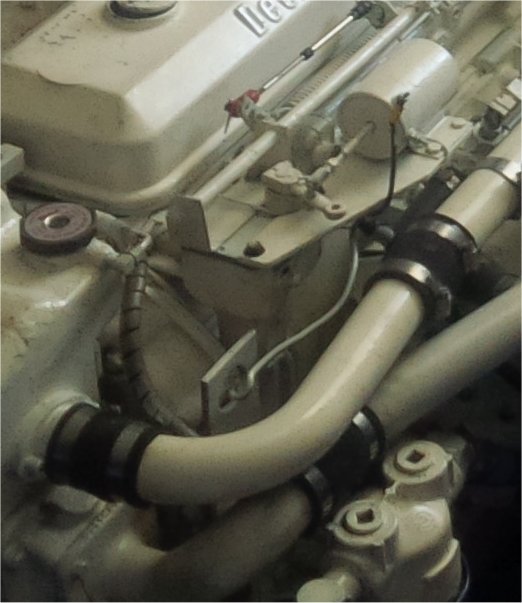

    Here a picture
  3. Capt Ralph
    12,649
    Usually a single weight, variable speed, mechanical governor.
    The serial number or tags will offer the best data.
    Why are you wanting to replace it?

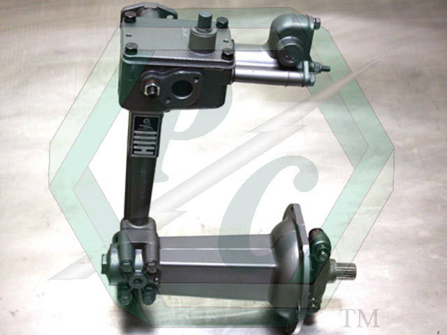

    Not able to RPM test today, but found the Reliabilt part# R-5144137 (6-71 A/B, Single Weight Variable Speed , LH model)
    New $2,459.78 rebuilt around $ 900,- (not 2-300 as stated before ;-)
