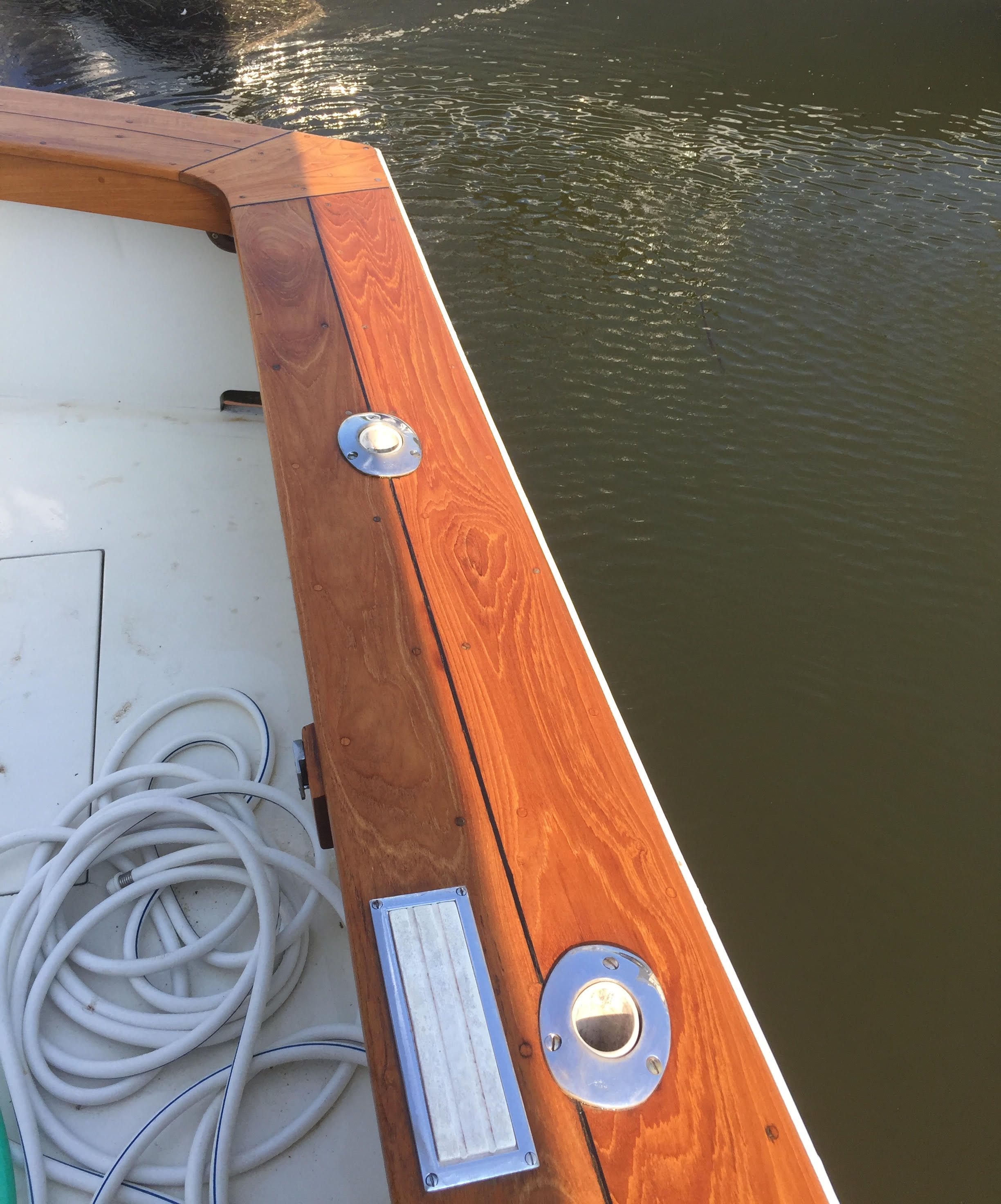

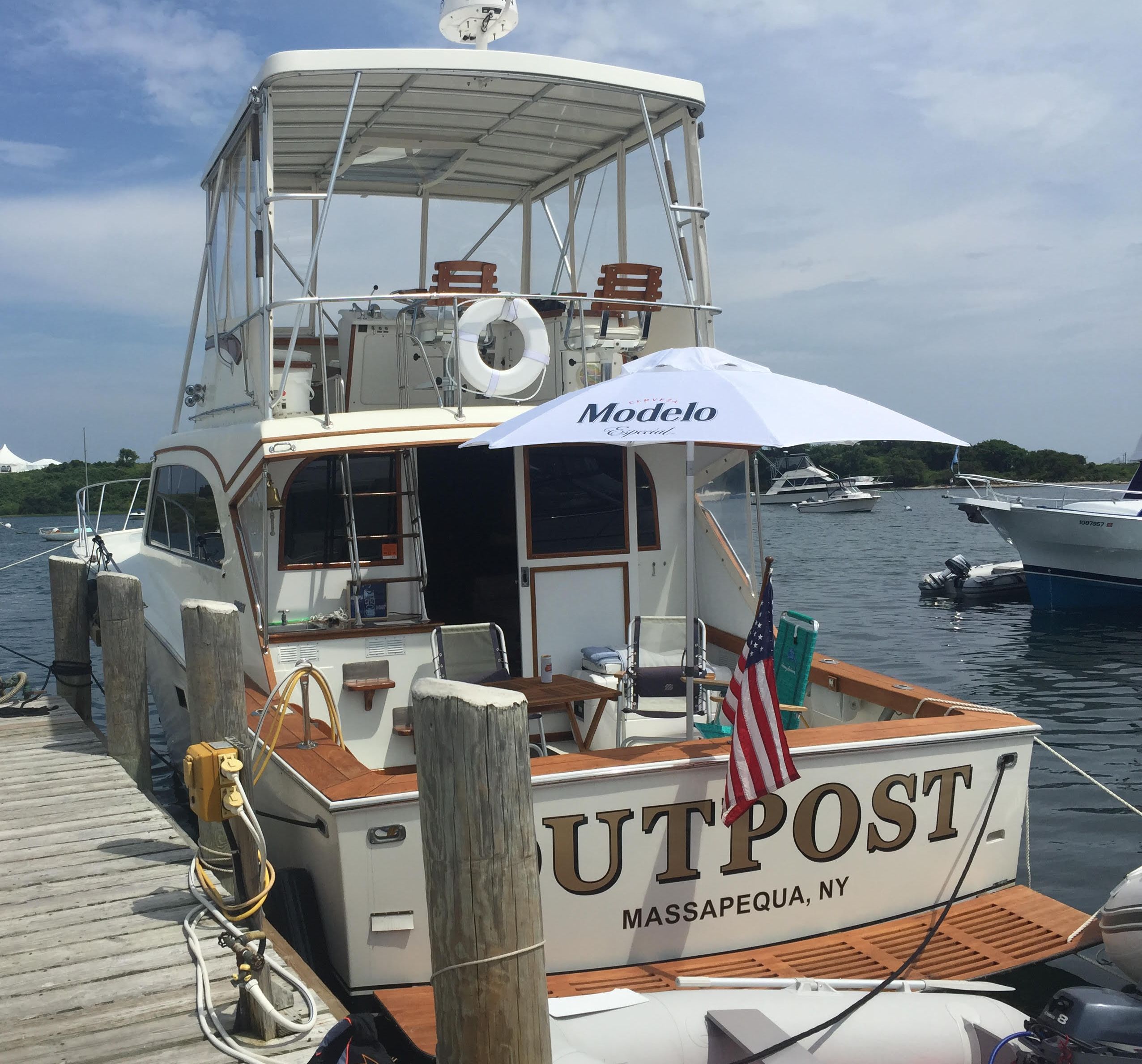

    This is my teak, same teak from 1976. I use a product called starbright teak sealer to keep it golden throughout the season. It has a just oiled look and feel .. but lasts a lot longer .. and does not need to be scraped or sanded or anything else to remove it. Starbrite makes a remover specifically for this product called "gel formula teak cleaner restorer" which is made to remove what is left of the starbrite teak sealer without having to use an aggressive two part cleaner. Two coats lasts a season.

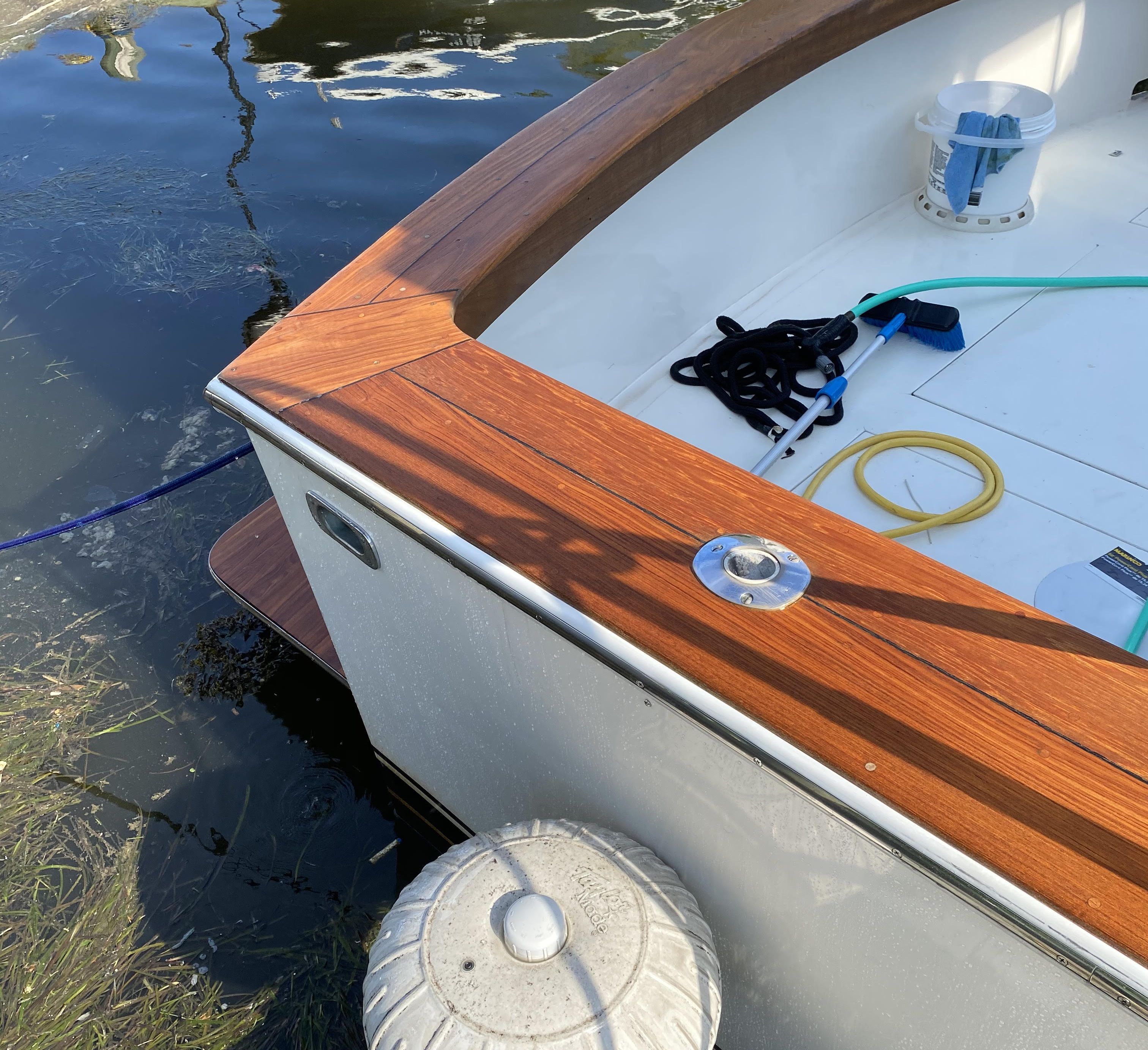

    This is how mine looks
    Reel Antsy likes this.
  6. AMG
    5,378
    Looks just perfect to me!

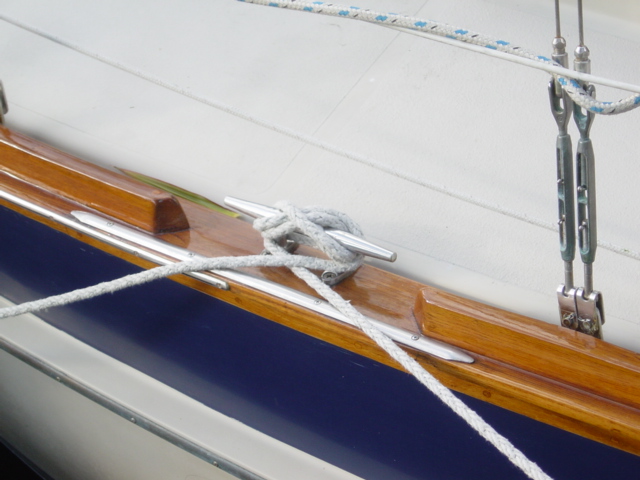

    This was my last boat with external teak:
    Stripped it all and built up 12 coats of varnish, then another 5 maintenance coats every year.
    Needless to say the boat was in Bristol condition and I was lucky to have a pro doing it for me. (There is an old thread on this forum about the guy: Mr. Greene)
